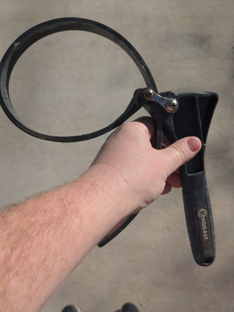

Do you have a strap wrench?
Otherwise, they have the clutch wrenches on Amazon pretty cheap:
https://www.amazon.com/gp/aw/d/B07HFFR9RR
Strap wrench.
Strap wrench.

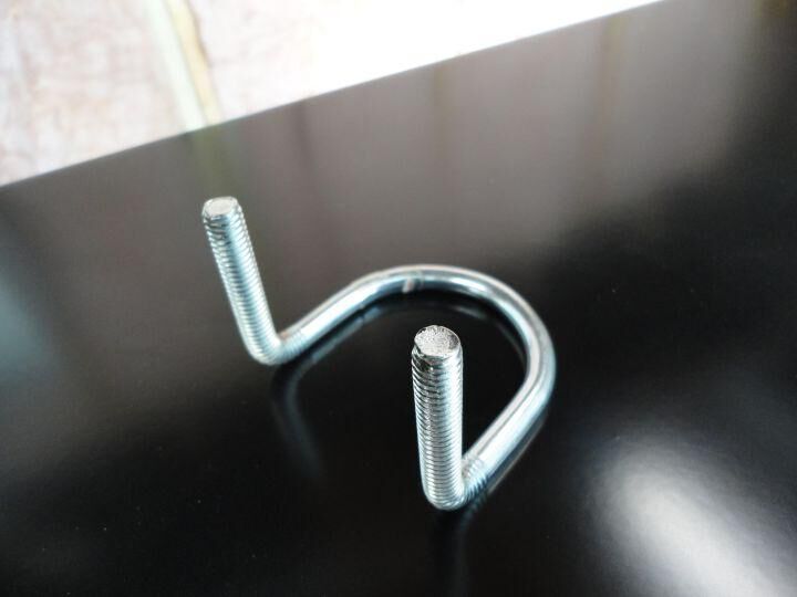

For the second time in 24 hours, I recommend a u-bolt from your local hardware shop.
And I vouch for it. It's watch VRM has in his shop and it works great.
