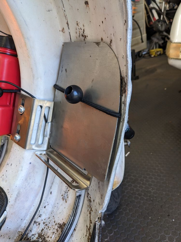

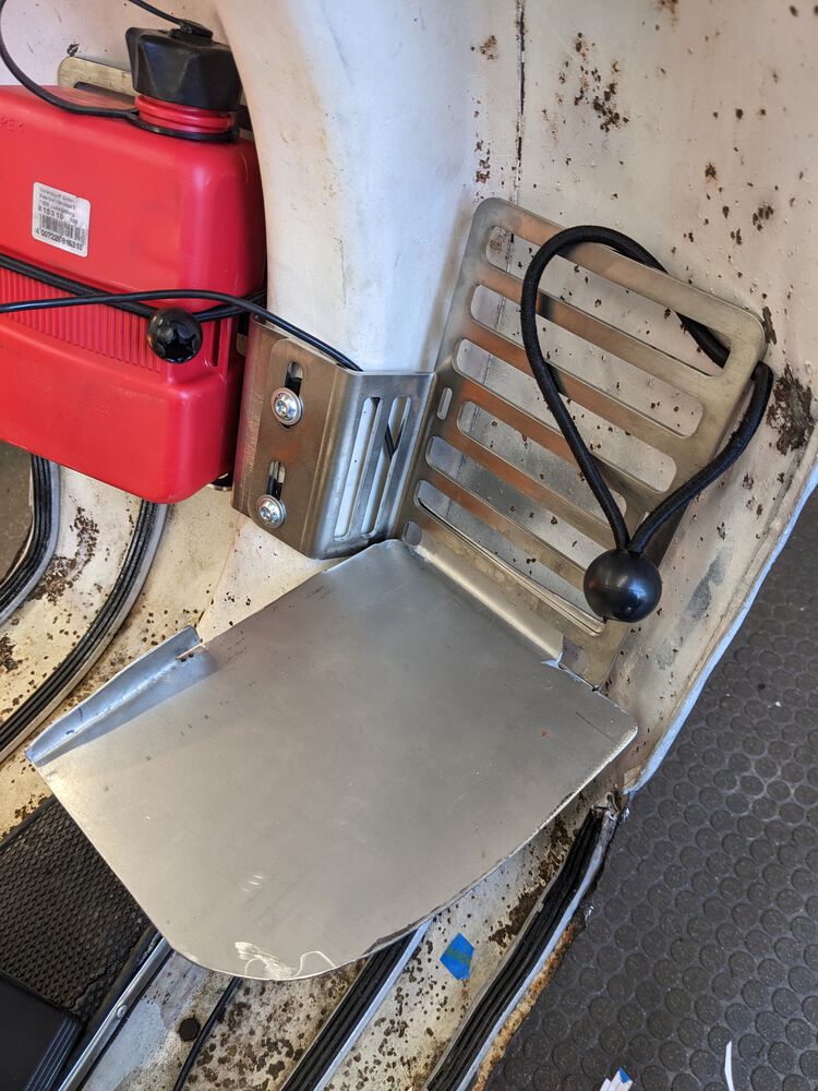

As I think we all know at this point, while I love me some Smallstate, like all smallframes it's a little short in the "carrying stuff" department, having neither a cowling nor legshield glovebox.
To help alleviate that, I installed a couple of MRP legshield racks, one for a small backup gas can. Not that I'd ever need it. And one for my 2t oil. Which is fine until I need to carry something else, say...some wine.
So to alleviate this problem, I decided I needed a better carrying option, but since I mostly wouldn't need it, it needed to be unobtrusive.
What I came up with is a fold-down shelf that hooks into the MRP legshield rack and locks into place both up and down, but which gives me significantly more carrying capacity than I had.
It's made out of 16ga sheet steel and it's pretty sturdy, but I think I'm going to get some 1/4" rod and weld that on along the mounting tabs. It would benefit from some better stiffeners, too, but I haven't quite decided what (if anything) I'm going to do about that. My original plan was to just put folds in the sides, but that doesn't really work, so that bit is still in progress.
Since I didn't do the downward fold on the right side (yet?), it's currently a little too wide and rubs on the legshield while folded up. That's not a big deal right now, but will need to be addressed before I do body work.
folds down
folds down
folds up
folds up
Like it's not even there

Like it, but wondering how you get a foot on the brake peddle when it folded down. Maybe there's more room than it looks…

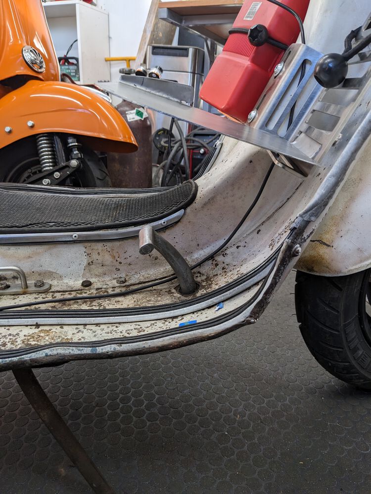

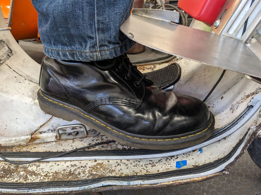

I'm still tuning it, so I went for the max size I could get away with. It's mounted pretty high, and only extends out 7".
I just went and checked and it could probably stand to be cut back 1/2" or even an inch.
action shot
action shot
I dunno that last picture looks like an amputation waiting to happen. Otherwise I am really psyched about this project and appreciate you sharing it.

The way I look at it, if you hit that thing hard enough to lose a foot, that's probably the least of your worries

charlieman22 wrote:
guillotine.
you are welcome to borrow my back pack.
Okay...so CM2 is not a fan.
It still needs to be cut back some, but I don't think it's *that* bad. I mean, it's not like I fashioned it from an old axe blade I had lying around. Razz emoticon
I'm with the guillotine crowd, looks like shin skin asking to be torn off when you stop abruptly for some reason, like a big pothole. My shin skin actually hurts a bit thinking about it. Now carry on with experimenting OSHA has left the building 😁

Christopher, that's what boots are for! Razz emoticon
Seriously, recall the use case: it's a fold-down for the occasional instance where I need to carry more than the base rack will hold. Like three or four bottles of wine, or donuts, or a bag full of yummy burritos and tacos.
I really do appreciate everyone pointing out the danger factor with the design. I truly hadn't considered it until y'all pointed it out, and I'm thinking how to balance the risk while still having an effective rack.

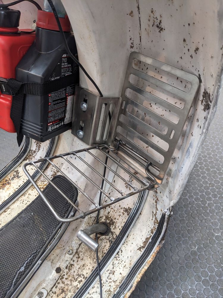

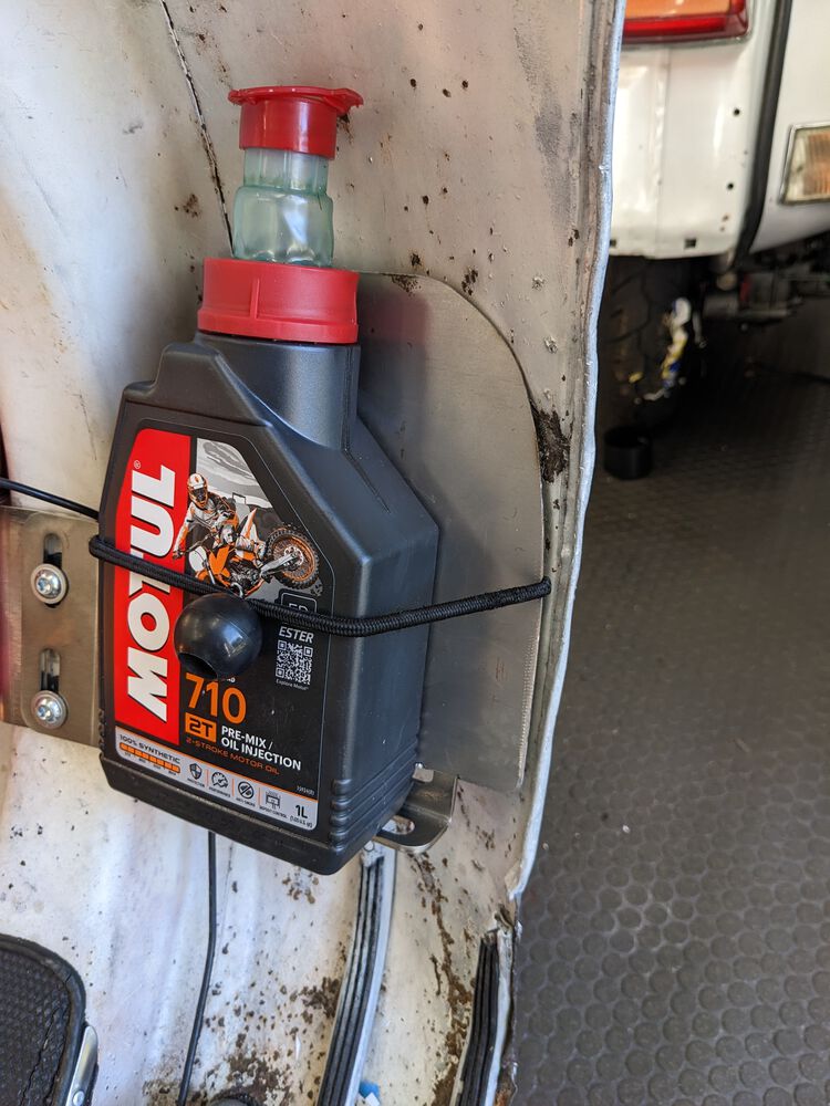

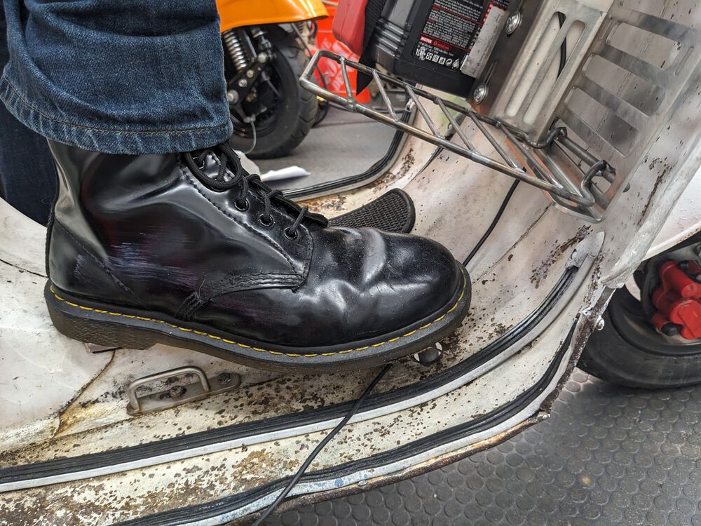

Okay...I built version 2.0 tonight. Significantly less dangerous, I think. I might do another because it has some aesthetic issues I don't love.
But this scoot isn't about aesthetics right now, so *shrug*. Anyways...
I used a 1/4" cross bar, but could probably have gone 3/32" in hindsight. The outer frame is 3/32" mild steel rod. It's right at 22" long. The crossbars are 1/16" and that took up about 36" of material.
I'll paint it tomorrow, and maybe I'll get a tub of plasti-dip and run it through that, too.
And it was a relatively uneventful build. I burned my finger when I bump the rack while it was still hot from welding...and a paper towel might have caught on fire from welding sparks (those things fly further than you think!)...
I wish I had just kept the frame square instead of trying to follow the curve of the legshield like I did on the sheet metal version, but these things happen.

Not bad Kemosabe. Maybe a bit shorter, but still, it'll work, and will look good, and have grip, if plasti-dipped.
1970 Sprint 150 & PX 200 / 225 and a shed full o shit
Posts: 191
Location: New Zealand
Posts: 191
Eeeeek!
20ish years ago I flattened a PX glovebox with my knees when a car didn't see me and pulled out. I'd hate to think what my legs would've looked like hitting that thing with bottles of wine in it. One knee is still gimpy today.
How about putting it on the other side?

Highly improved.
Your rack has a crumple zone!
I mean - it would be wrapped around your ankle like a felon's anklet - but you would probably still have an ankle.
Lighter gauge still - also seems a solid plan...

charlieman22 wrote:
Highly improved.
Nah, that would be nothing like a felon's ankle bracelet. So I've been told...
Given the upwards angle and shortened length, I really suspect it would just fold up in any sort of crash worth discussing. It's also now short enough that the issue would be if I had something sturdier than a burrito on the rack at time of impact.
I think this one will work. I may shorten it a bit more, even, but I don't think I can go any lighter gauge without compromising structural integrity.
There's a lot of stress on the pivot point up at the front, and it's completely unsupported other than the lip of the rack.
and other than the asymmetry out on the end, it'll fit on either side, unlike the sheet metal version. I put my 2t oil on the other side with the gas can when I need to carry something.
And the thing that keeps getting overlooked in the whole discussion is that I'm not riding around with this thing in place all the time. It's explicitly for when I am carrying something that needs to sit on the rack, which isn't all that often. The rest of the time it's folded out of the way. To me, that's an acceptable level of risk. If it weren't I probably shouldn't be on two wheels anyway, and especially not the two wheeled beasts that I build.
