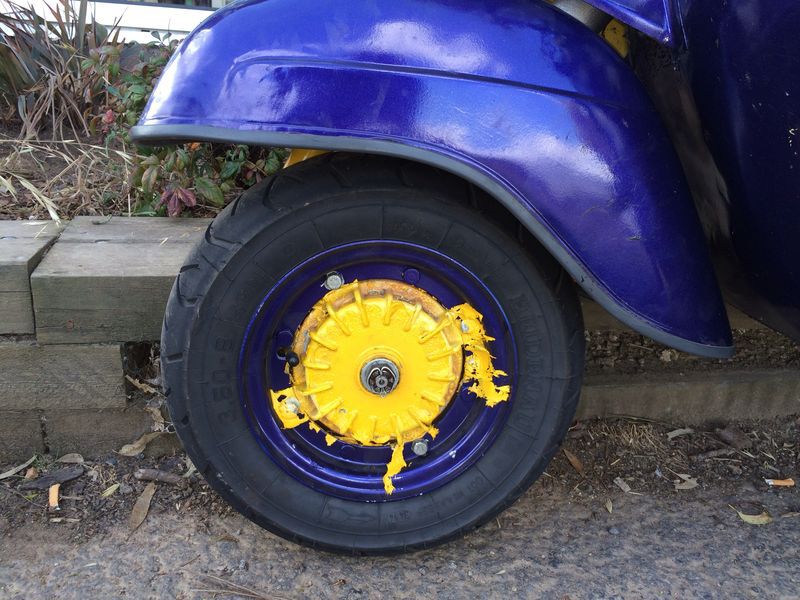

How effective are 8" VBC brakes?
Once setup (& if you are crazy enough) you should be able to:
- "chirp" the front inder heavy braking.
- barely use the rear (mainly used to let person following how fast they can take the corners)
- use it while accelerating to "move/change" centre of gravity
- use it while accelerating so you can be on the throttle around corners
- use it so much that the paint MELTS
