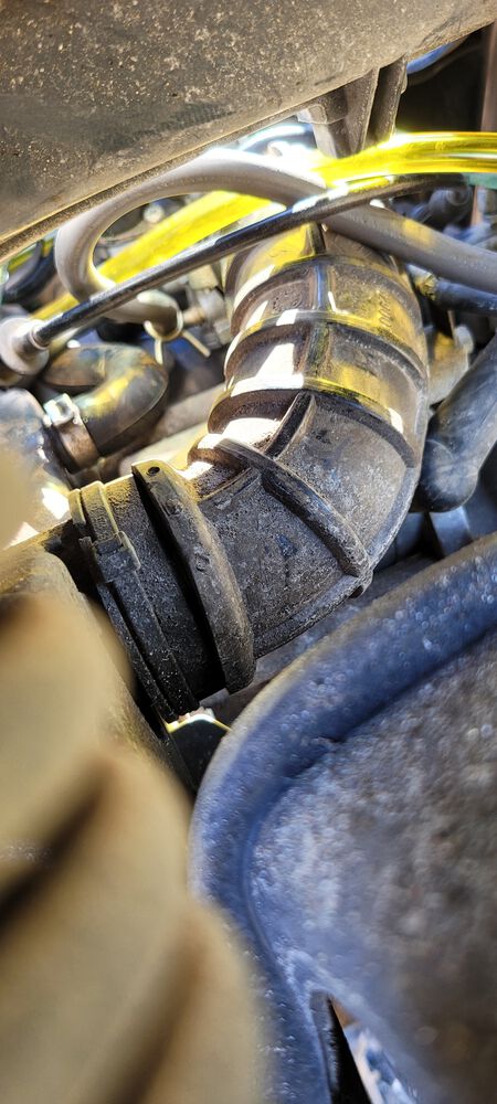

While doing my check I noticed the air intake tube coming from the airbox has a tear in it at one end, but I doubt that is the ultimate problem, as it would just be sucking some air from atmosphere rather than through the relatively small air filter. (I ordered a replacement that comes on Wed, so we'll see if that actually helps at all)

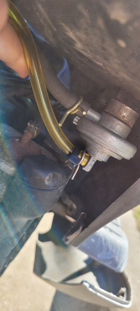

Carburator area, yellow lines are brand new going to fuel tap, blue line is definitely newer than 2006 and still very clean and pliable, going to SAS vacuum port. Top is manifold going to engine, bottom is coming from airbox

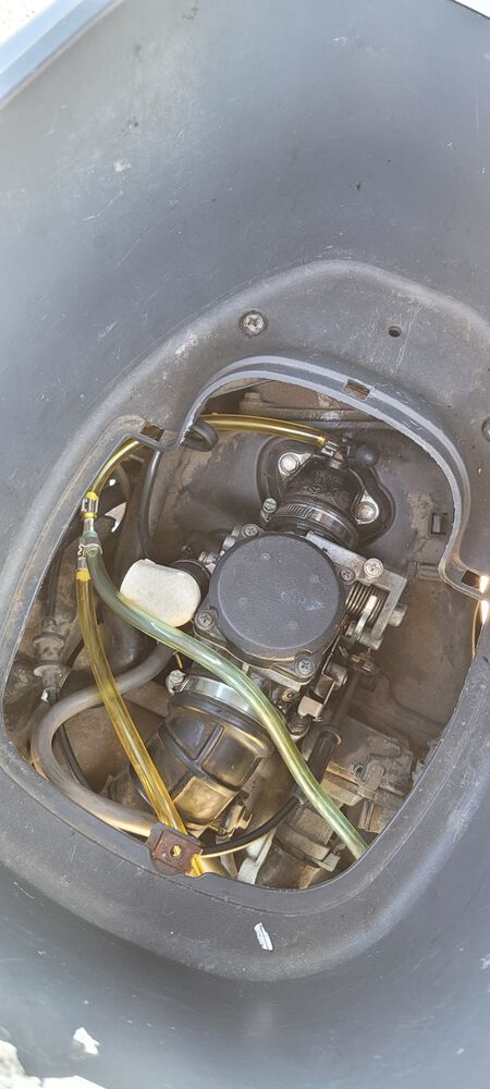

Other end of vacuum lines, gray is fuel line, yellow vacuum line to fuel tap valve, blue (lower left) is going to SAS valve.
Back side of air intake tube, not sure if its visible from the pic I could get without taking the body off, but there is a separation near the airbox connecting side about an inch and a half long and maybe 1-2mm wide

slap a piece of duct tape over that crack in the intake and see what happens.
that tear is probably what's causing you grief. with a CV carb, the intake tract is tuned so any changes, even slight, can result in poor running issues.

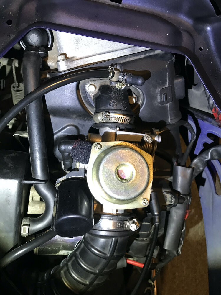

GabrielA wrote:
There are 2 places the evap hose connected to, one is a nipple on the rubber air manifold connection just after the carb, and one is on the carb breather that goes to the float bowl. I DO need to make a makeshif filter for the float bowl port, but it already came like that when I bought it and drove fine for months since so it was a low priority I kept putting off. That port is left open to air to let float bowl breath, I only capped off the manifold connection, as it was recommended to do so during the procedure.
I recently removed my EVAP system mainly because I ruined a perfectly good air filter by overfilling my gas tank. That won't happen again, and if it does, it won't matter.
I didn't like the idea of leaving that bowl vent port open, nor did I like the looks of the improvised piece of hose with foam wrapped around it. So, in my past I worked with some lavalier mics that have very small foam windscreens. I bought a 5 pack of them from Amazon for around 5 bucks.
It fits (once I bushed out the port opening
: I used a vacuum cap with the end cut off as a bushing). I WORKS! And it is VERY inconspicuous. Want one? Send me a pm and I'll mail it to you. No biggie. [img]/Users/rick/Desktop/Screen Shot 2023-02-19 at 2.28.14 PM.jpg
