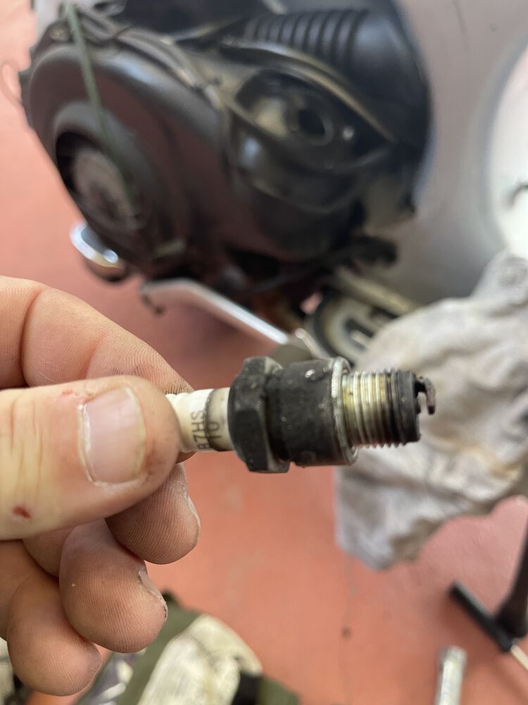

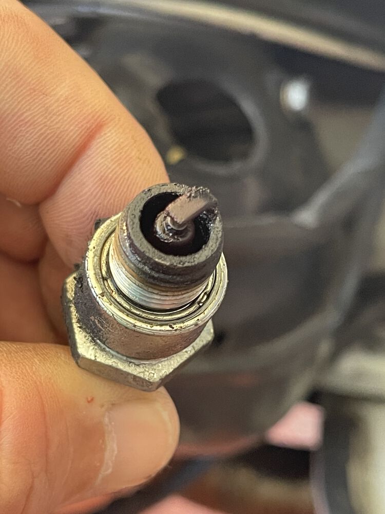

What do you guys think?

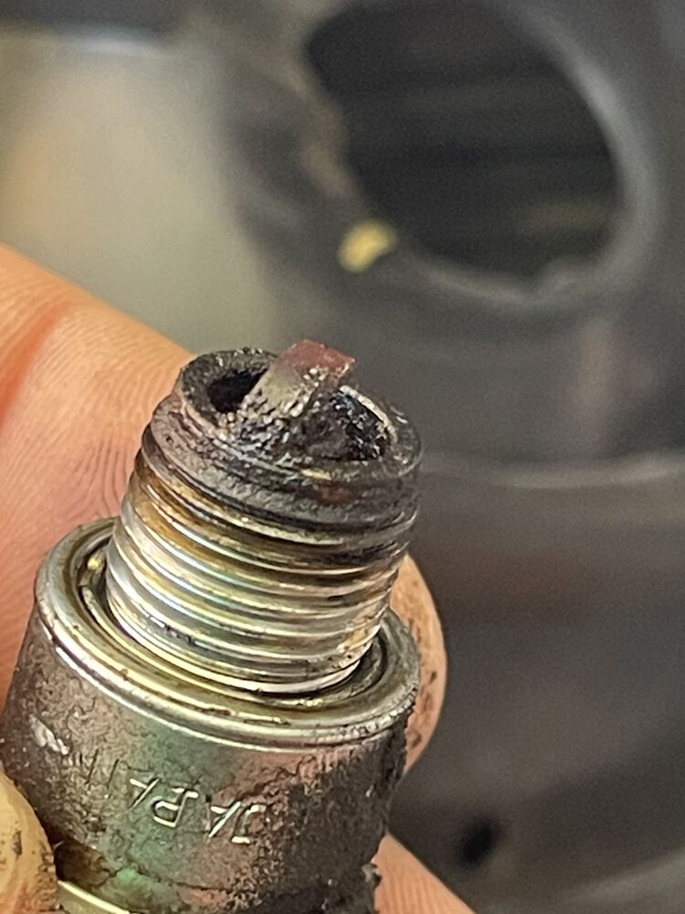

Same

What mixing oil are you using? I never had a spark plug look so gummy with motel 710. Are you using mineral oil or semi-synthetic?

I suspect you have an oilsucker (leaky gasket allows gear oil to get sucked into the crankcase). FreakMoPed has done a lot of Youtube videos on this.
