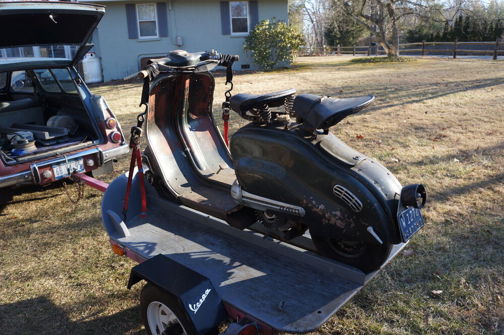

Just what I needed.
5 miles from home $400.
Frame says : * 544028 * 125LD. Can't figure out the year but probably '58 - '59?

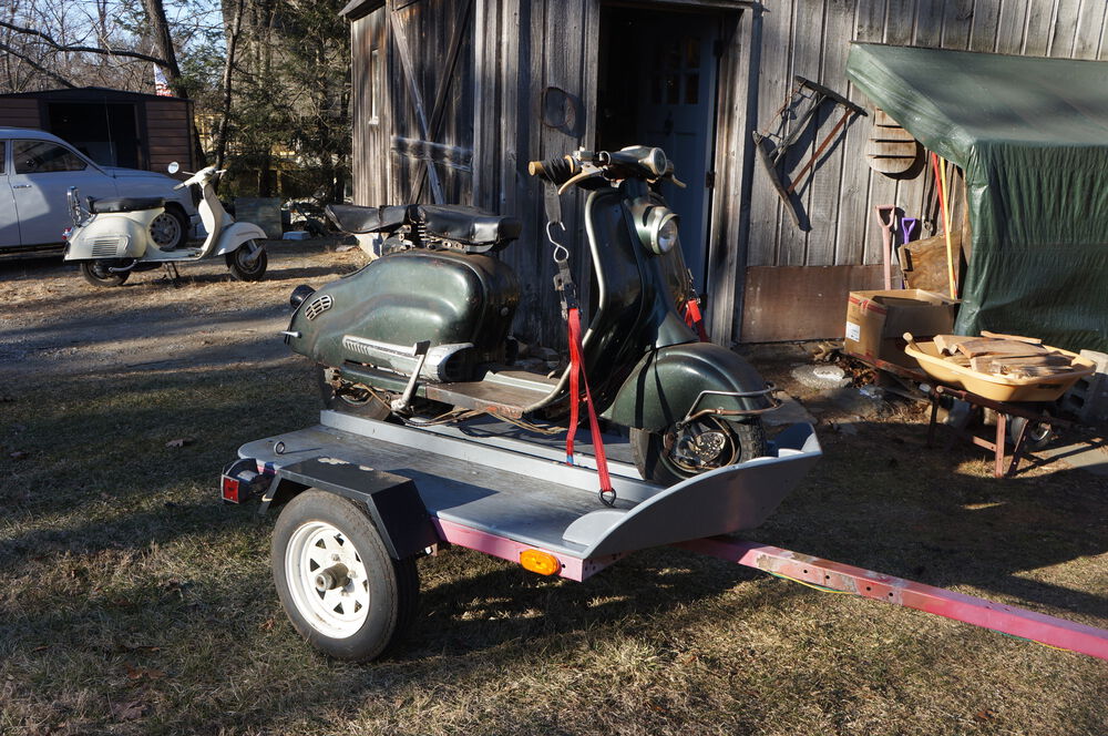

Those pictures are at my shop. It's mine.

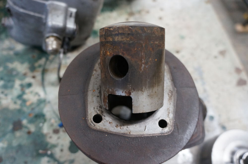

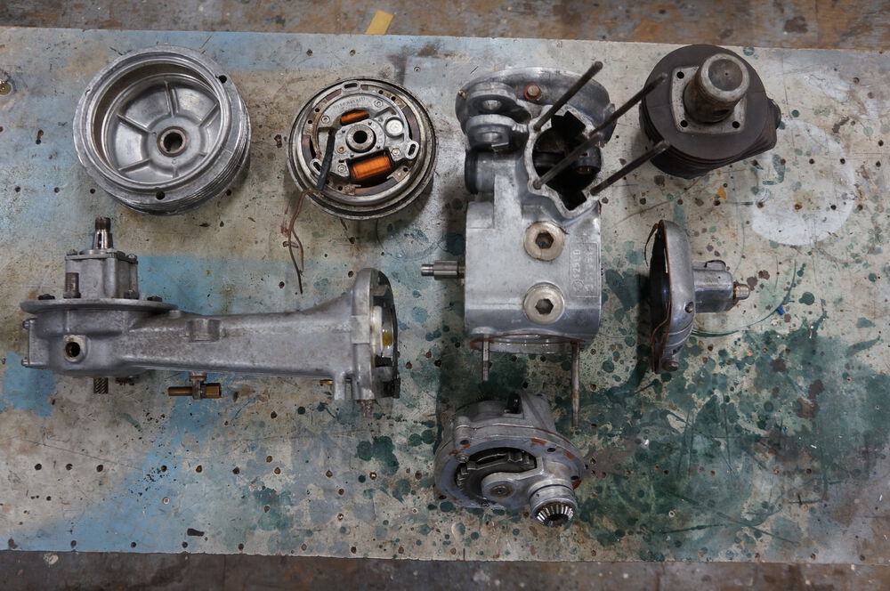

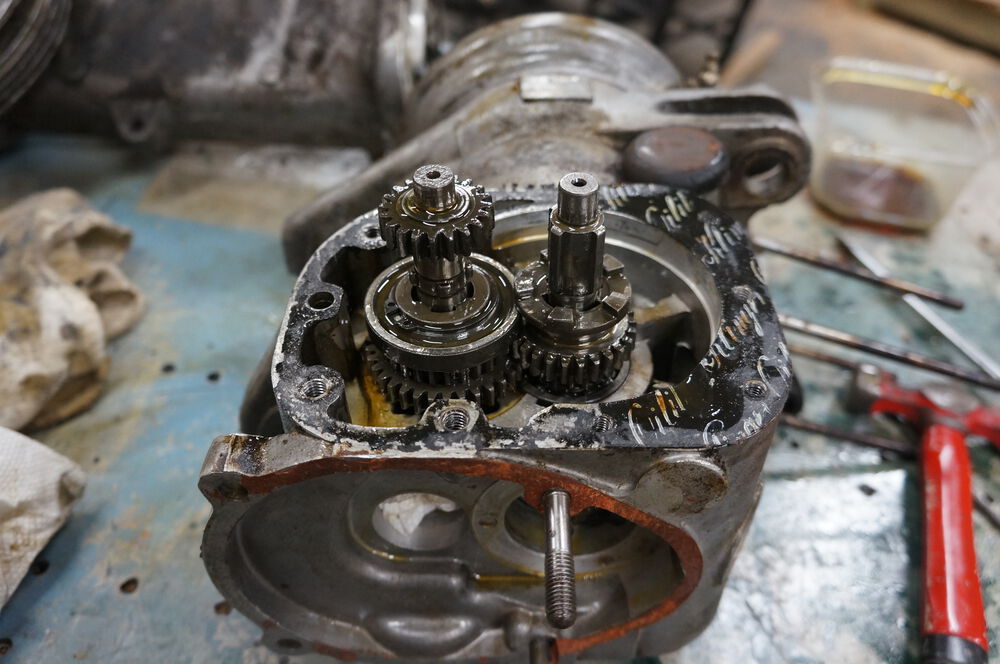

I am just working on freeing up the piston. Luckily, it's up towards the top and what I can see of the bore looks pretty good. The guy I got it from filled the bore with MMO quite a while ago but I'm going with PB and brake cleaner and heat. Clutch feels gunked up so that's coming out.
I am sure the seals are shot but maybe they'll work well enough. I am hoping I can flush out the internals and maybe hear it run !
In '63, I pulled a Briggs and Stratton motor apart when I was 13 and starting a project like this is one of my favorite things to do. It's an adventure cause very little is familiar on this thing. Some of the proceedures for working on this motor in the manual boggle my mind but it's fun as it starts making sense.
Two days ago I was thinking about starting work on my bathroom that I've been putting off for 35 years.....
The odometer shows 91389 miles !
I know you're an old hand, but any time I see this I feel that it must me mentioned: please be careful with brake cleaner and heat!! depending on the flavor of brake clean you're using when the contents are exposed to heat it can turn into poisonous gas.
as for the PB, I've hit that with heat many time I don't think that has much effect toward drain bramage.

greasy125 wrote:
that's some professional grade lolly-gagging. it takes commitment to actively procrastinate, but I don't like tile or plumbing work either!
I can put off procrastinating.
And I hear you on the brake cleaner. I am careful.
Just using it in the soak, thinking it will help wick the PB down. I clean out the bore before heat.

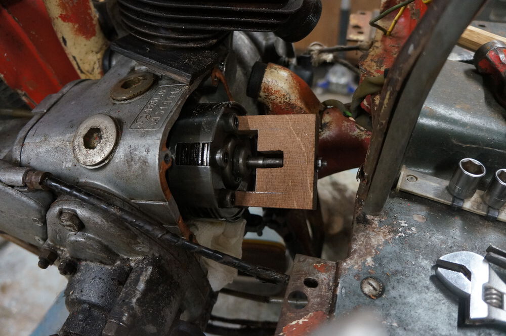

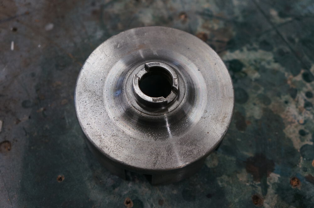

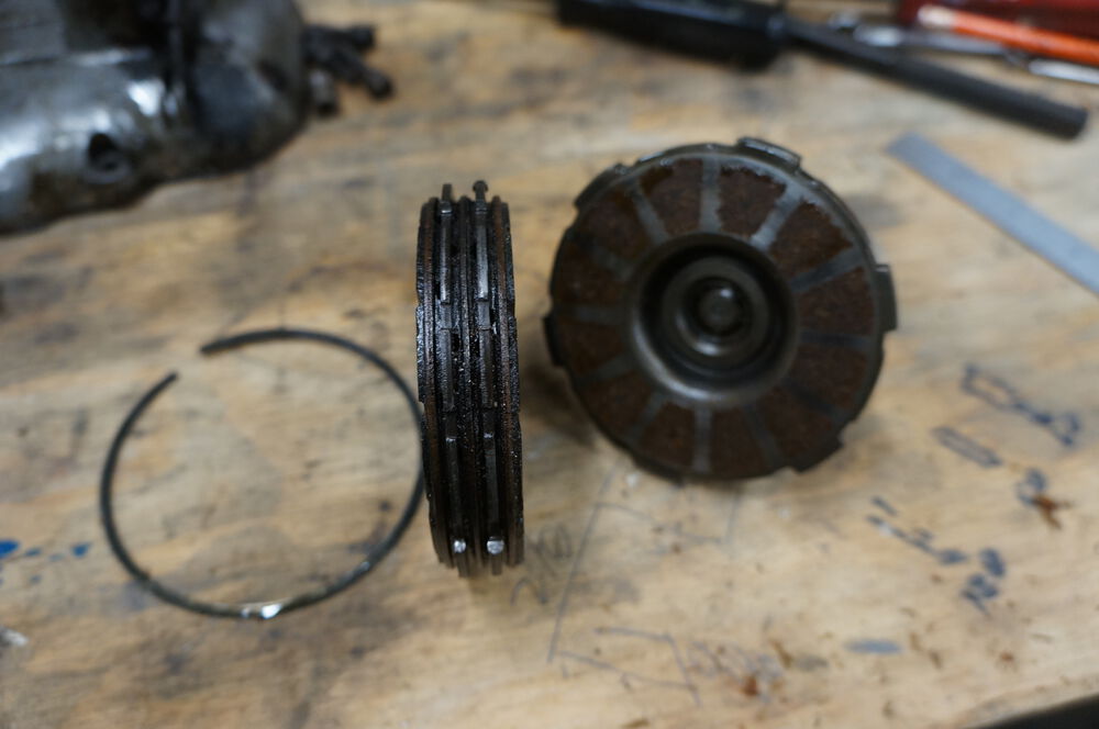

Clutch came apart all stuck together. The basket looks new. The pull rod has small ball bearings on the end. Heard one hit the floor and found it.
And, FWIW, it's actually carb cleaner I'm using.
I like the clutch compressor thingie. Did you make it?
@moto64 avatar
Posts: 2448
Location: NYS
@moto64 avatar
Posts: 2448
Location: NYS
Being a worker of wood with a complete shop, it is often easier to fab something out of wood than welding. Depends on the force required. That is one of the new "mahoganies" (decking) and is very hard and dense.

...also... We need to see pics of the car that LD was attached to via trailer...

'63 96 two stroke and the '68 95 V4
