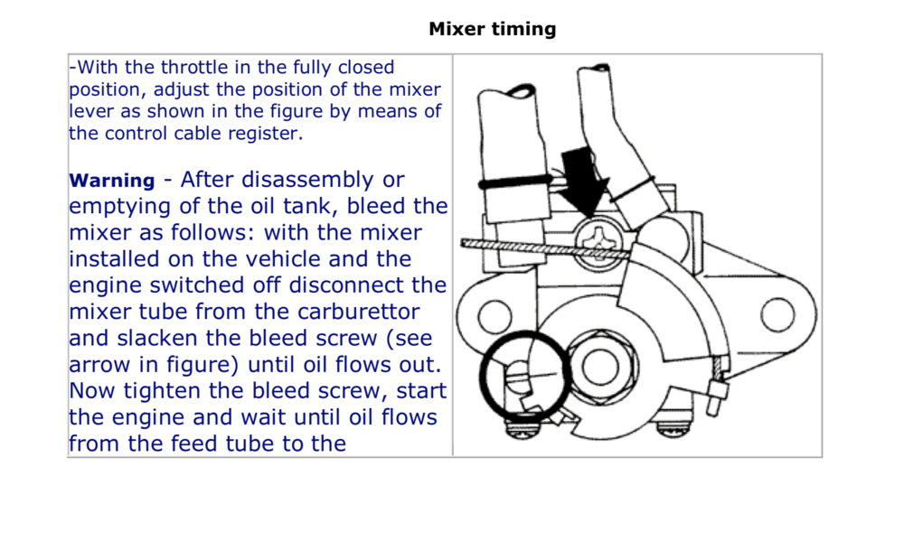

you'll need to bleed the air from the pump and prime it. here's from the FSM
