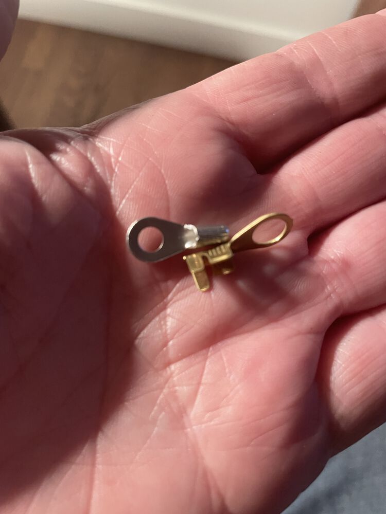

Need the proper terminology for the brass ring terminal pictured below.
All my searches for ring terminals return the silver type ring terminal with only one crimp point.
Need the brass type that crimp both on the wire and on the insulation… my google fu is weak mobsters….Any help appreciated!
What is the bottom one pictured called?

You mean like these?
Hilitchi 605Pcs Non-Insulated Open Barrel Wire Crimp U Shaped Ring Crimp Terminals Assortment Kit (M3 M4 M5 M6 M8 M10, TC-1, TC-A, TC-B, TC-C, TC-T) https://a.co/d/3Ttbg02

Ahhh… thanks.
Adding "u shaped" to the ring connectors query got me some good returns. Gratzi!

Go to www.digikey.com, search "ring terminal". Filter for brass material + TE connectivity - AMP. This returns about 400 results, including various sizes of the type of terminal you have pictured.
For example,search for digi-key part number 60394-1.
I couldn't narrow down this search any better, or get a direct link to any specific terminal, but I hope you get the idea. Hope this helps.
60394-1 16-20 AWG #10

Do you know the stud size and wire gauge you need?

It's m3 or m4 …
And I think 18g?
Rally 180 junction box and standard Vespa wiring loom.

M3, unless the Rally junction box is weird.
