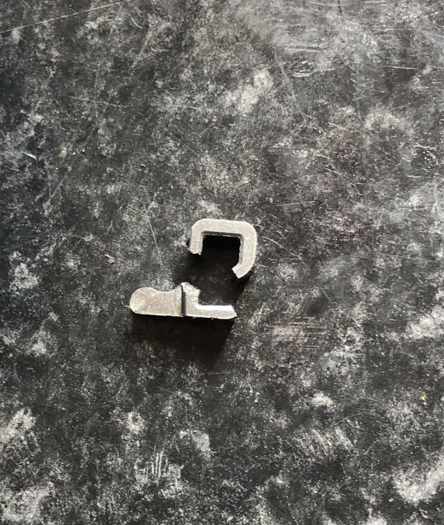

I did the cables but it's still the same jumping from 3rd to 4th and back to 3rd. I broke down the clutch didn't work so I had a look when I got home and found a part in the clutch cover was broken as you can see in the photo. Could it be that part doing it. Or maybe it's a shim problem I'm thinking now because I use a drive shaft from a p200e I had years ago so it could be the shim. The gears are new.

Great catch, but that will have no impact on your gear issue.

Also, the broken part in your photo is the little part that sits underneath the brass plunger in the cover that pushes on the pressure plate. You'll have to take the spring and the arm off the cover to replace it.
