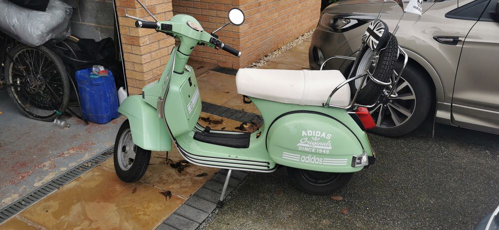

Hi everyone glad to be hear and looking forward to talking to you all 👍 I'm new to the scootering scene so please bare with me for what might seem some silly questions.
I've just purchased a lml star 2t which I'm loving but as everyone one does want to make my own with decals and stuff nothing major just a change but the one thing I'm struggling to find is the paint code for it,
I've come across a max meyer code which is 1.298.6399 but no one seems to use this code to mix a tin of spray up for me, it's probably been asked loads but does anyone know where I could get the correct code from please.
Thanks in advance Alex.
This is the colour and max meyer code just thought this might help

To say this up front: there is a possibility that Vespa and LML have not used the same paint!
Info about the paint Piaggio 399 Verde Pastello
Paint data
Manufacturer: Piaggio
Color code: 399
Color name: Verde Pastello
Painted: 1968 to 1975
The Vespapaint is available from the following paint manufacturers:
Lechler
Glasurit (color name: VERDE)
Mipa (color name: VERDE )
This is a glossy solid color paint. Please note: A clear coat must be applied over two-coat or three-coat base coats!
Source: https://www.vespa-lack.de/lackuebersicht/piaggio-399-verde-pastello/
Find shops to order on link above…

I checked again: Vespa/Piaggio and LML do not have identical colors. That means you have to look for the LML color!
You should find the color code of an LML on the type plate or in the service booklet of the scooter.
Found a List of LML paintcodes: https://www.scooter-center.com/media/pdf/92/6d/b5/Farbcodes_LML_c10.pdf

First: do you have a picture of your scooter?
I post you a link with LML Color Codes:
GermanGTSDriver wrote:
I don't know if that list is complete, but there a only two green tones with could match the picture you posted:
Color: Green LAGUNA (GRÜN LAGUNA)
MAX MEYER:
PPG: *0041
NEXA: ?
GLASURIT: SG027.50
Color: Green Mint (GRÜN MINZE)
MAX MEYER: 6002M
PPG: *0016
NEXA: 44XXB
GLASURIT: ?
Paint Pen available at SIP: https://www.sip-scootershop.com/en/product/paint-pen-sip-lml-lml-mint-6002m_61076800
If I'm right about any of these, though, the next drink is on you.... 🍸

Yeah I think mine is the green mint and yeah defo drink on me if I can get sorted 👍

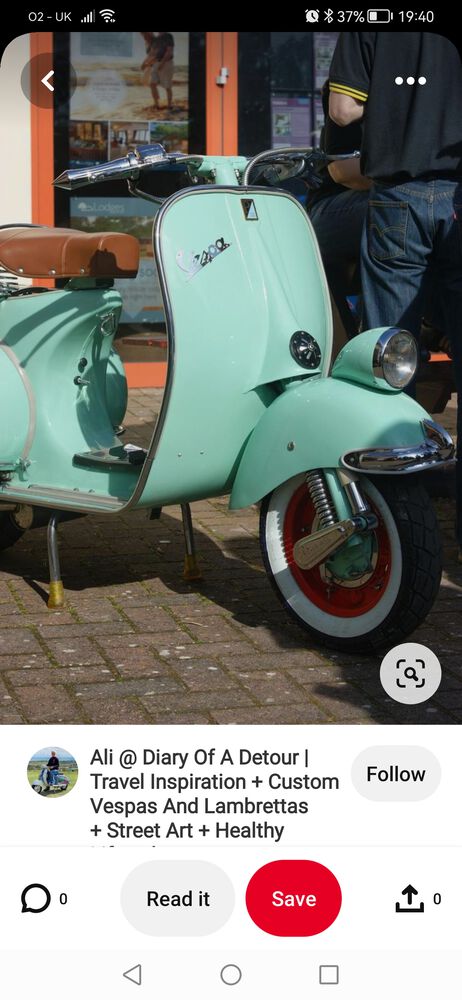

That is a good point the spray can is not for any of the body panels as these are OK but I'm wanting to change the wheels and paint the hubs tha same as the bike I've seen some pics and they look quite good to be fair, I know it personal choice and if it doesn't look good I'll just go back to the normal hubs 😂😂👍👍

Like these I think 👍
Thanks again for all your help 👌👍
Any reasonable paint shop can perform a color analysis with a digital spectrophotometer. This also allows production tolerances and changes in the existing paint due to environmental influences to be taken into account in order to remix a paint.
