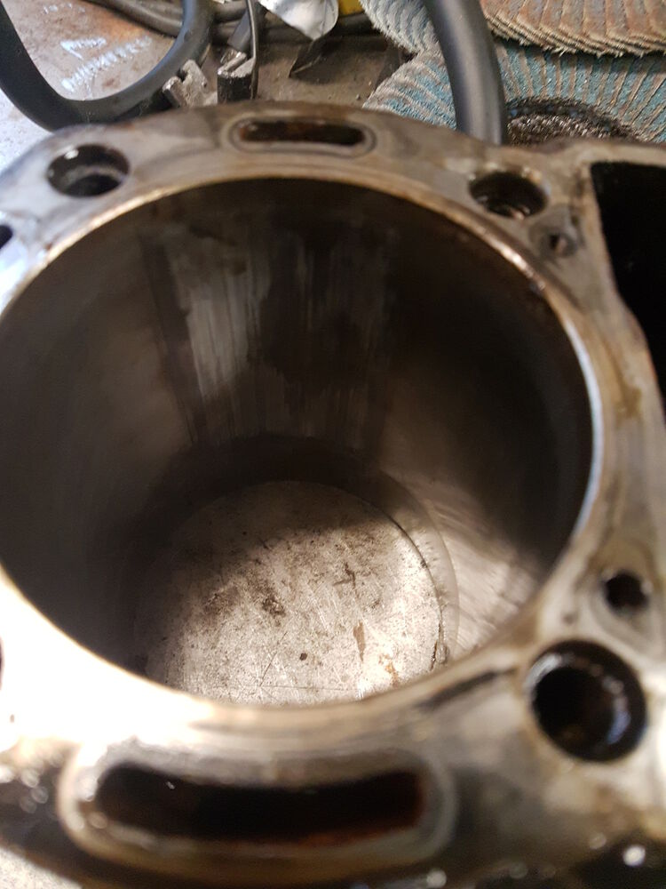

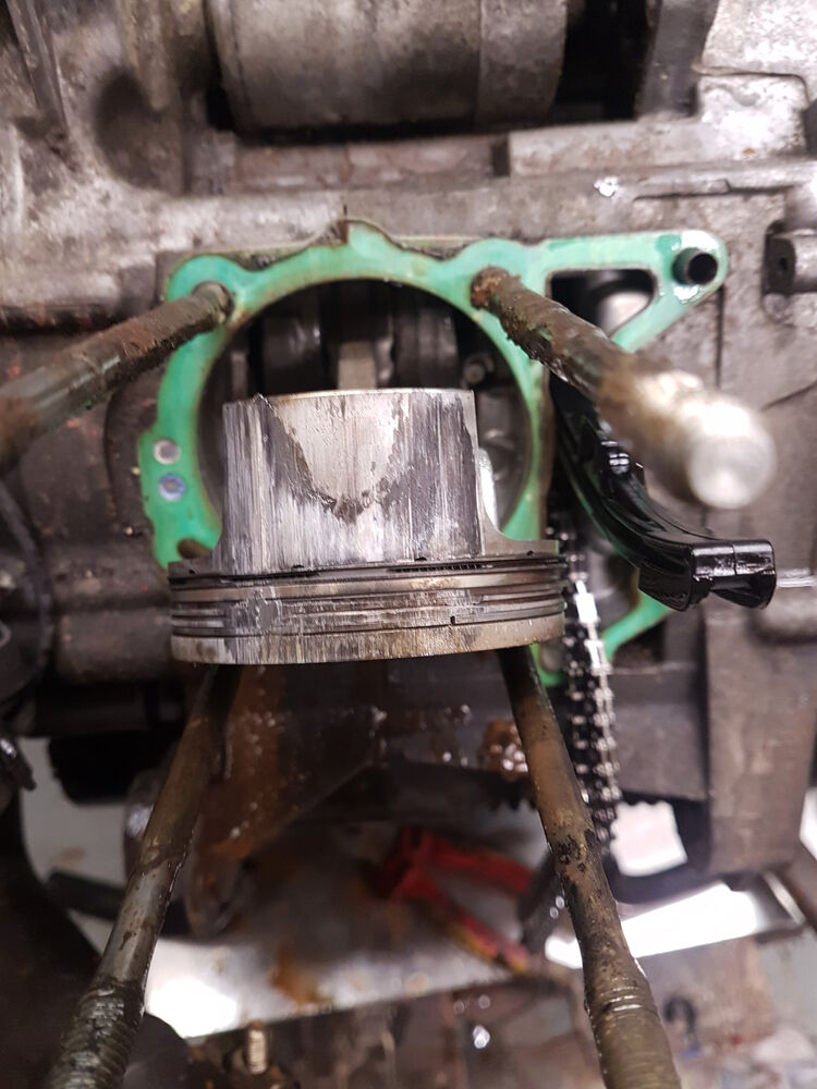

Just had a customers scooter in with a not starting problem, compression was low, On stripping it down to see what the problem was i found melted piston.
It held the rings into the piston as you can see from the pics. oil was good fan was working as it should and the coolant was good and at the correct level. he told me the only thing he had done differently was to use E10 petrol as his local filling station had stopped selling E5, and he would have to ride 10 miles to get some. he was advised by the garage owner E10 would be fine, well as you can see from the pics, Its not.
pissed & broke.
pissed & broke.
pissed & broke
pissed & broke

That looks more like oil starvation than using the wrong gas.

what's the face of the piston look like?
highly doubt a few miles of bad gas would do that type of damage.

I once owned a Honda RS 250 which had been run low on oil and it looked exactly like that.
It looks like the piston skirt has been scoring up against the liner and destroyed the ring's integrity.
Has anyone checked the dipstick ?

I'm thinking it was run low on oil, or went well past the OCI for quite some time.

Piston face shows no sign of pre-ignition which I was always informed was a sign of unsuitable fuel. I think something else is the problem. I also run my 1972 Trimuph 500 on e10 with lead substitute without a problem. The main issue with ethanol is its incompatibility with rubber, plastic and hydrophilic properties.

Did the oil look like it had just been poured in?

where is everybody seeing the top of the piston at? I only see the view from the side where the ring pack is and the barrel.
also, looking at the motor, why does it appear as though the coolant is straight up mud? is it just the lighting? if not, that was wayyy overdue.

The top of the piston can be seen in the bottom picture, at BDC. Notice the huge gouge in the cylinder wall. The studs are definitely caked in something. It could have been a lubrication failure, severe overheating, or a mechanical failure in the engine, but it is not related to ethanol.
@greasy125 avatar
Posts: 15121
@greasy125 avatar
Posts: 15121
no, look closely, there's no dish for it to be a piston, that's the workbench top.

I'm still waiting to see the piston crown. and the combustion chamber. and while that's open let's see the cam and rockers.
I have a hard time believing *anything* was tip top just looking at the nastiness of that coolant. I can only imagine the rest of the motor was cared for with the same regard.
the funniest thing is that when people bork up a motor real good they always come in with fresh oil or recently changed or grossly overfilled from topping up after realizing something has gone awry. all done in hopes of saving something beyond repair or hoping the save some face.

Just because "there was oil in it" doesn't mean the oil pump was doing its thing.
X9's used to be notorious for chewing up the plastic oil pump gear if gas (petrol) got into the oil - a common occurrence for those who just used to ride a couple of miles to the station and back, so the engine didn't heat up completely.
