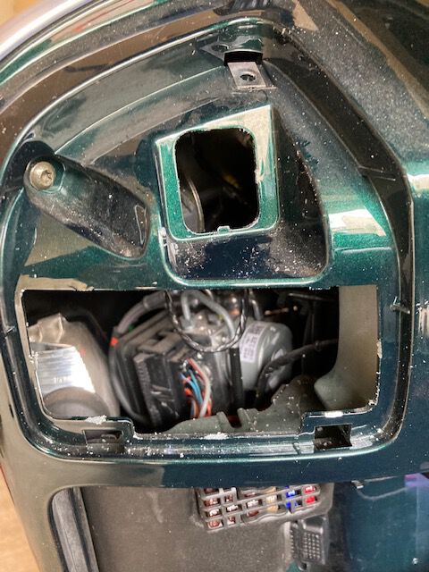

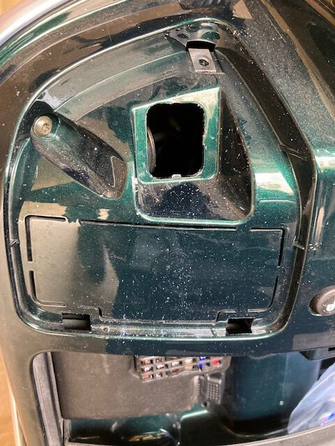

I was all ready to install a 12V outlet in prep for my 2000 mile plus tour in May. Then I removed the left knee pad where it was going to go. Imagine my surprise when there was no easy access like in the old days! There are two 'scored panels' in an otherwise solid extension of the leg shield behind there. I removed the panels with the aid of a hacksaw blade but found that the alarm wires are also missing. And there are lots of interesting gizmos back there now! It looks like the best bet is to run the wires down behind the leg shield to the battery (not a simple chore but the best solution?)
Anyone out there done this 'mod' and have any suggestions?

All good suggestions. I want the 12v outlet up where I can plug in my Garmin GPS. The USB in the glove box is fine for charging a phone while riding but I don't want wires coming out of it while in motion. I'll fish around in the 'black hole' and see what I can come up with. It would be nice to have power switched but not necessary and I'll probably just run a fish of some kind down behind the leg shield and pull the wires through as bluside suggested. I'm sorry they felt the need to 'close up' things behind the knee pad. I used to reach in through mine on the 2010 to open the glove box (after I got it back from being stolen and the release would no longer work.)

So today the temps were in low 60's for the first time since....I don't remember. I decided to fish the wires through to the battery (thanks for all the other suggestions but there is no room behind the shield through the little hole to access any connectors, at least not for me). Easier said than done. I ended up removing the two in-board floor 'rubbers' and fishing the wires to there, then with the help of some 12" wire ties, over to the battery. It required the use of a pair of forceps (very handy tool) and a needle-nose pliers plus some industrial strength duct tape. But it is done and I now have a 12V outlet, live all the time, in my left knee pad. Should I want USB, I'll just plug in an adapter. I haven't decided where to mount the GPS (I've attached a RAM mount to the mirror stalk in the past and it worked but......)
