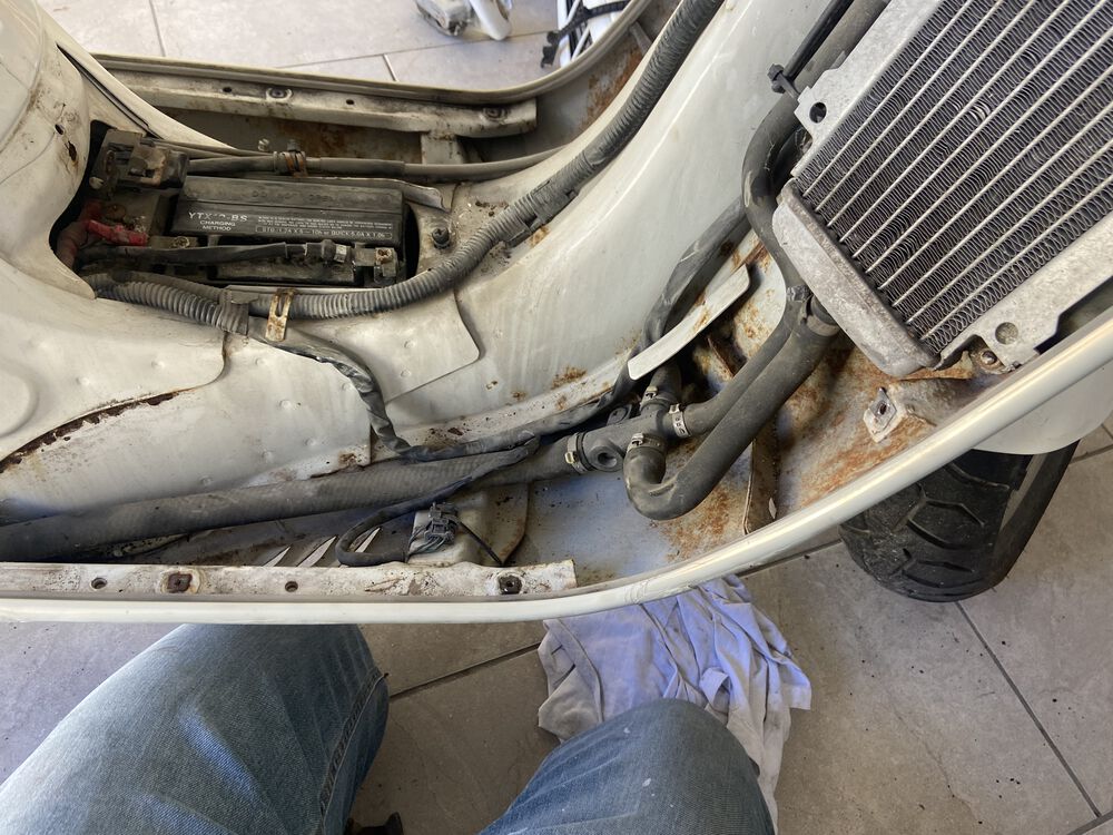

Where is the starter relay?

I'm sorry you took everything apart, but you can easily spot the starter relay once you lift open your seat and remove the pet carrier...
It's the red squarish part near the opening. You can't miss it.

Thanks very much…. It was very easy… and now everything is ok… 👌👍
