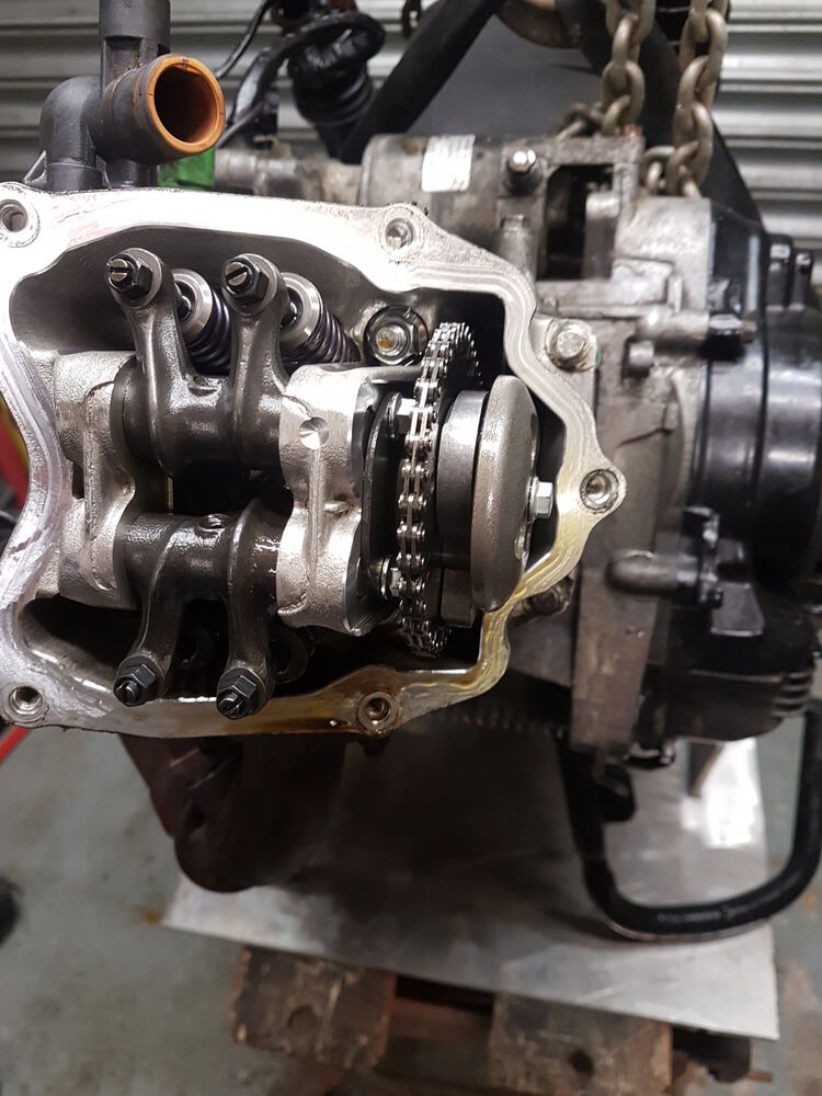

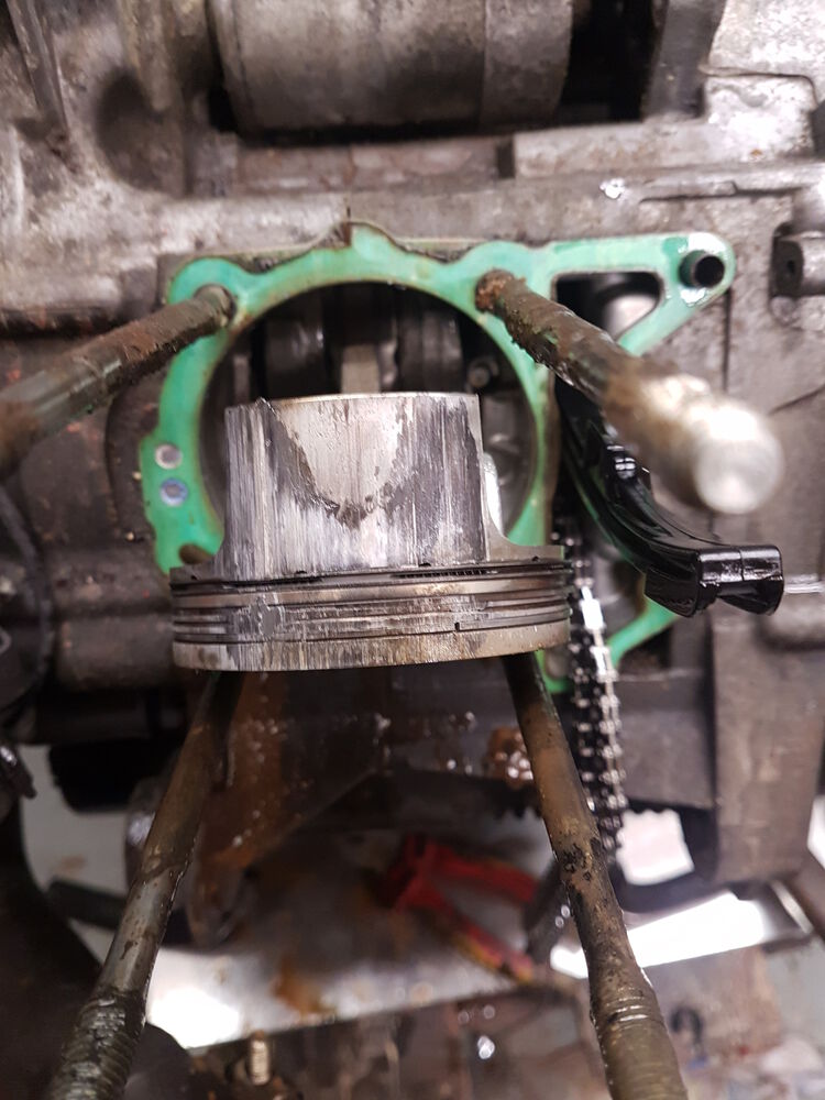

Ths s wht 10 dd t n ldr gts ngn, th ns thy clm cn s t s th sm mtl prts s th nw ns th rbbr sls r jst 10 prf. s th sm wr nd tr n bth ngns wll ccr, stck wth ss 5 t hs n thnl n t dspt th 5 sgn t th pmp.

tige wrote:
This is what E10 did to an older gts engine, the ones they claim can use it use the same metal parts as the new ones the rubber seals are just e10 proof. so the same wear and tear on both engines will occur, stick with Esso E5 it has no ethanol in it despite the E5 sign at the pump.
please stop spreading this misinformation. poor quality fuel did not cause that damage, lack of lubrication did.
I agree. With all that crap and rust in the coolant system there was definitely something wrongโ€ฆ
I service these things and i can tell you its a lack of servicing and rider responsibility.

No lack of lubrication at all, the oil level was fine as was the rocker plenty of oil up there when i took it off, so that put that theory to bed, The water system was a tad on the rusty side, but no sludge in it,
