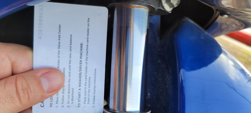

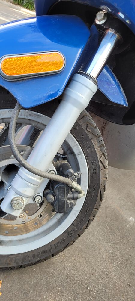

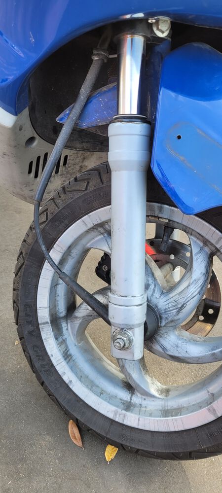

Good seal was part # 599201 (31.8x42x7)mm, pictures attatched. I dont have a ruler/calipers on hand where I'm at right now, but standard size card for reference on travel distance (about 4/5 of the card length is shiny = 2.7 in = somewhere in the ballpark of 68-72mm travel?)
EDIT: Also the 2007 Manual does mention the Wuxi forks, so perhaps mine are one of the other two types?
(Ignore the oil streaks on wheel lol, I cleaned the front brakes when I did it)

OK. Fork was made by MVP. Unfortunately, as you have already figured, there's no updated info from Piaggio. Last fork they installed on the "old" Fly and still used on the newer model was made by "Wuxi Top" and manual said 96cc of 10W fork oil...
