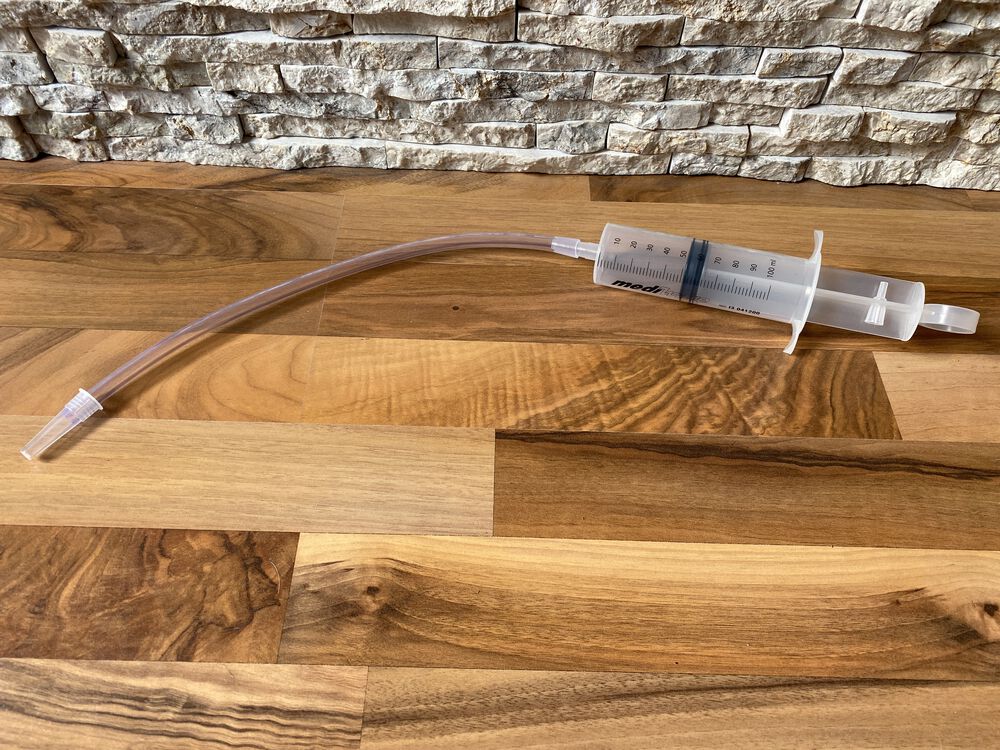

baba12 wrote:
After reading this post, I have a question about what oil measuring container do members use? I have trusted the gallon container that has calibration on the side to be approximate what I need to add then add a bit more after I check the dipstick.
I got a large syringe from the pharmacy (100ml) and put a gasoline-proof hose from the hardware store on it. The hose is just long enough that I can get to the bottom of the oil bottle and simply pull the syringe. So I can measure exactly for refilling and come easily to the opening behind the exhaust.
In the picture the hose is still a little too long, best cut as short as necessary, but just so that you can easily reach the bottom of the oil bottle.
