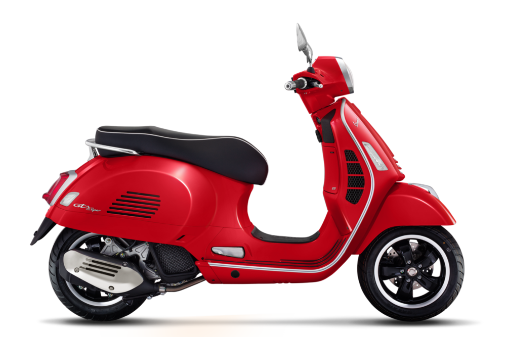

In pictures the radiator is the give away. I'm assuming that just won't fit on the small frames?

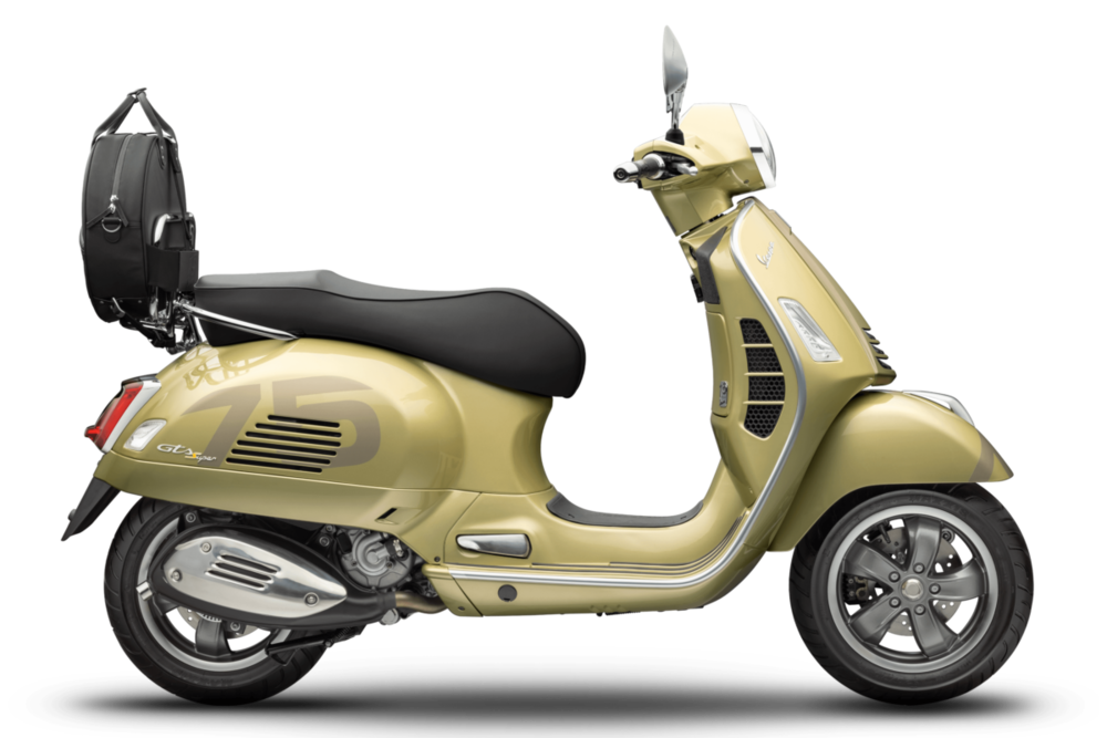

Right. The radiator in the water-cooled 125/155cc engines sits directly on the water pump (see red GTS) and not as in the 300s behind the glove compartment (see golden Vespa, which makes the construction of the 125/155cc less complex.
Clearly, with the water-cooled engines must go somewhere... whether the water-cooled engine including the required auxiliary units would fit in a smallframe, I have no idea.
