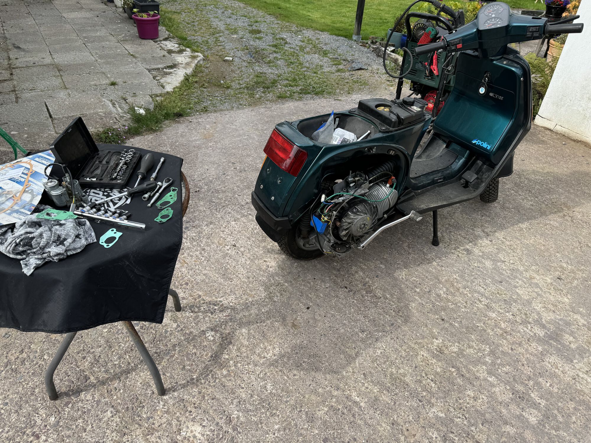

I have been searching for a classic vespa for some time but have not found anything suitable nearby. This Cosa which I think is a 1988 or 1989 I am open to correction.
I didn't know what to expect when going to buy it only that it was a project. The guy didn't speak English and I didn't speak French. Turns out it had the cylinder and piston along with lots of other parts in boxes. The bottom end didn't seem to have any play so I took a chance on it.
I have purchased a BGM 177 cylinder kit which I believe is a direct replacement with no jetting changes required.
When I compared the BGM piston to the coating damaged piston and cylinder I discovered they are the same size so it think it's a Polini 177 kit which was removed so I will probably need to look at jetting.
It's my first Vespa so any advice or input is very welcome!

I initially just wanted to bang a piston in this and get it running but after I had another inspection of the rotary valve with the airbox off I found quite a bit of swarf and other misc sh1t that I didn't like the look of and I have no idea where it came from. See the first image for a shot down the cylinder opening for the scoring on the crank/valve.
I checked the rotary valves clearance with a feeler gauge and it seems to be OK. I'm going to split the case this week hopefully and make sure there's not too many foriegn bodies floating around the crankcase, I should be able to check the clearances in here again, I don't want to ruin the cyclinder just because I wouldn't take the time to split the case.

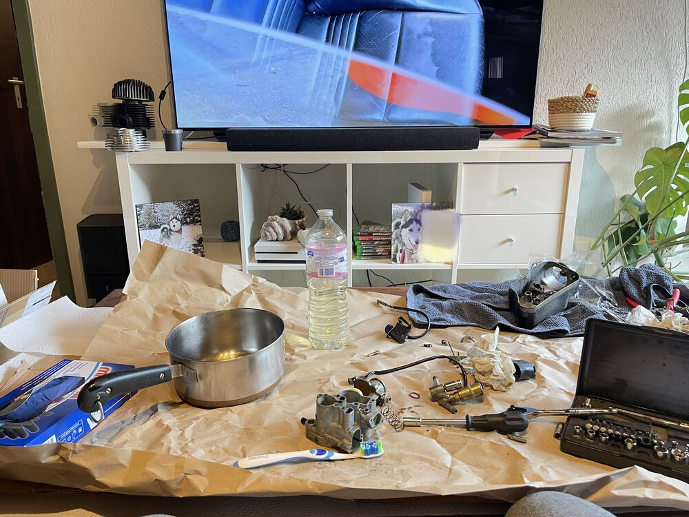

I had a free day yesterday so I brought the carb into my apartment and stripped it down. The throttle was completely stuck on the bike and I don't think it has been run since like 2004.
The slide in the carb was completely stuck. It took a lot of petrol and levering with a screwdriver to free it up. I cleaned everything down in a pot with some petrol and a toothbrush.
I then decided to check the jets which were fitted. I'm not very familiar with how 2 stroke carbs work so it took me some time reading up what each jet did. The wiki on here was particularly helpful.
It turns out that there is the following jets fitted:
Air Corrector: 140
Atomiser/Mixer: BE3
Main Jet: 83
Idle Jet: Missing
Starter/Choke: 62
It's a Dellorto 20/20 SI carb just for reference.
I'm thinking the main is too small for a start and that I'm going to move up to a BE4 mixer. I have some time to decide what I need though as I'm not going to buy anything else until I split the case and figure out what else is needed.
Thanks all for the comments and if anybody has any suggestions on the selection of jets I need then I would be delighted to hear.

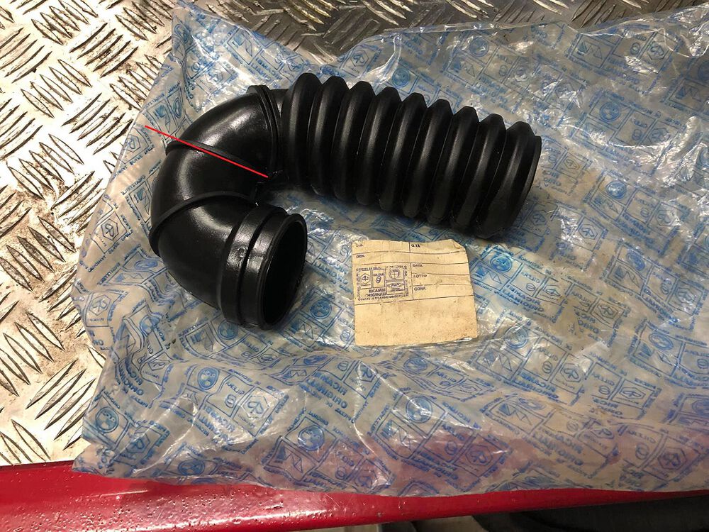

Would you be able to direct me to any more information on the secondary air box? If I lift the tank is it quite obvious?

You will see it under the tank. Also the bellows will need trimming. And the slot of the cassette filter must be blocked...

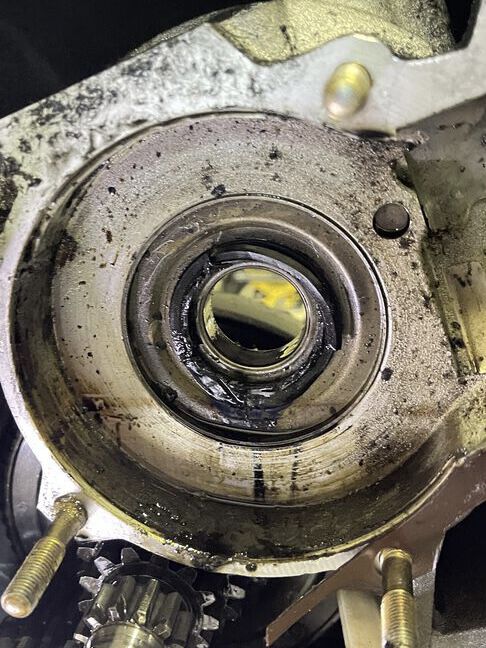

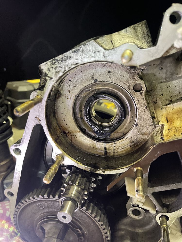

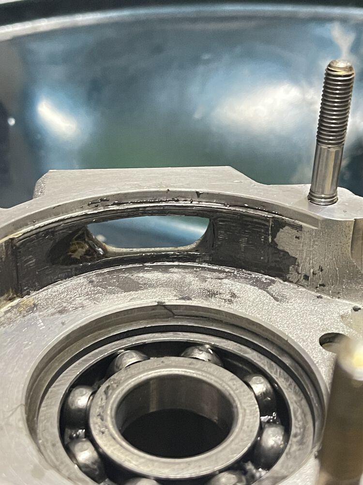

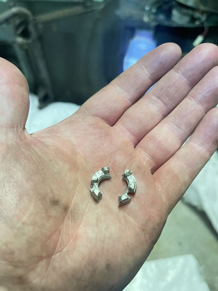

I got the rest of the case removed this evening. Looks like the crank oil seal spring has broke loose and been injested by the rotary valve and a few other bits have wrapped around the crank.

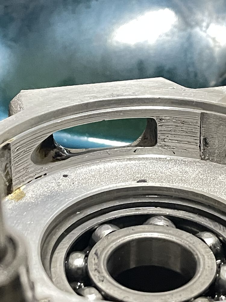

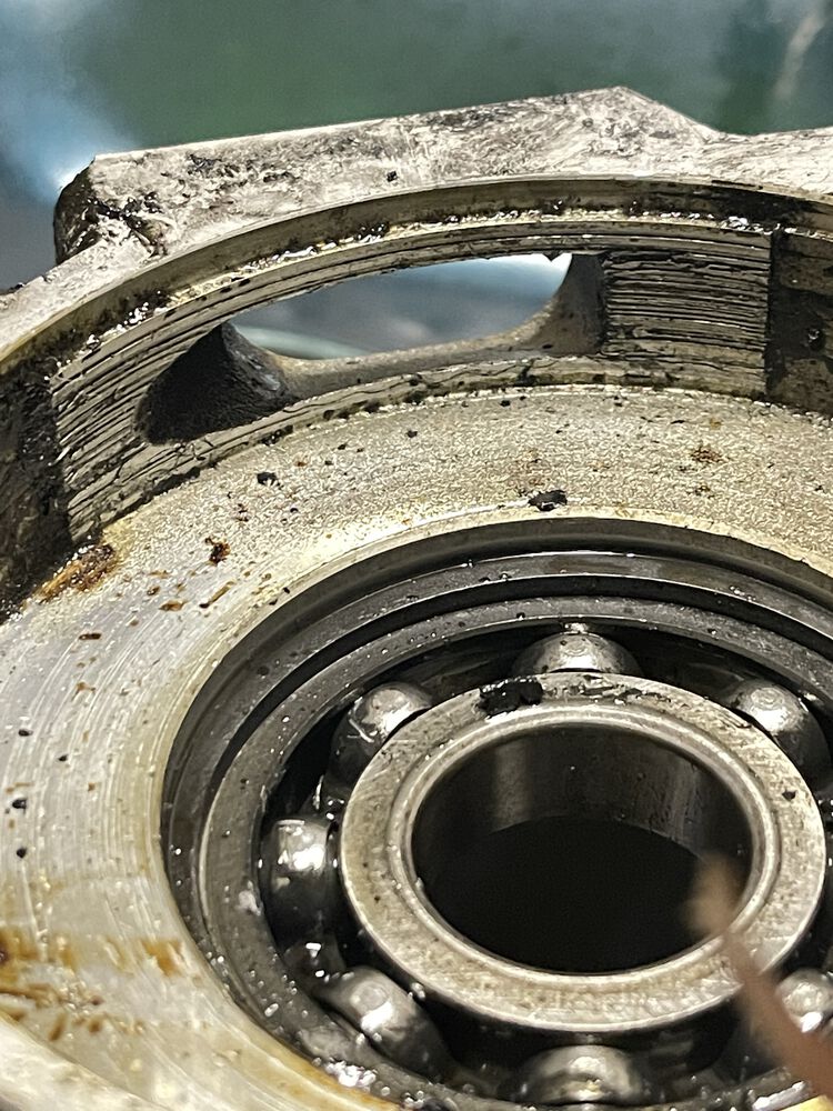

I wonder if anyone could give their opinion on the rotary valve? the pad is fairly well scored like the crank. I've never run a 2 stroke with a rotary valve before so maybe it's some way useable? The last thing I want to do is put it back together though and then loose the cylinder.
Anyway it looks like it's a good excuse to go for a longer stroke crank.

More pictures please

Can we see a pic of the rotary pad in the case? The better the seal, the better they run - but they will run ANYWAY with some scoring and damage. If you don't like what you find, you can take a look here for some good options, including an easy one recommended by the factory: Welding and remachining rotary pad?

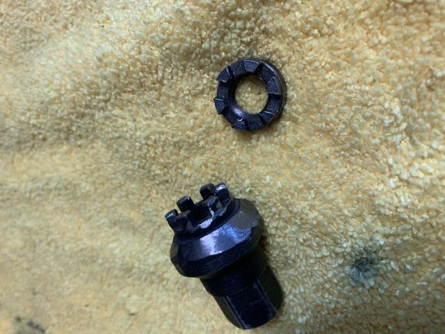

I received the castle nut tool for the clutch and it just keeps slipping. Looks like I'm going to have to drill out the nut on two sides and break it in two to remove the clutch and then the crank. This job has grown legs Facepalm emoticon

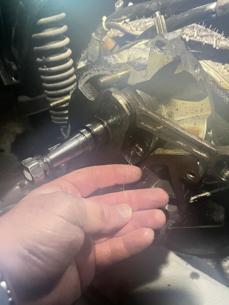

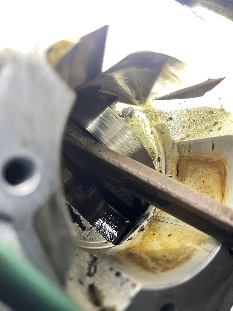

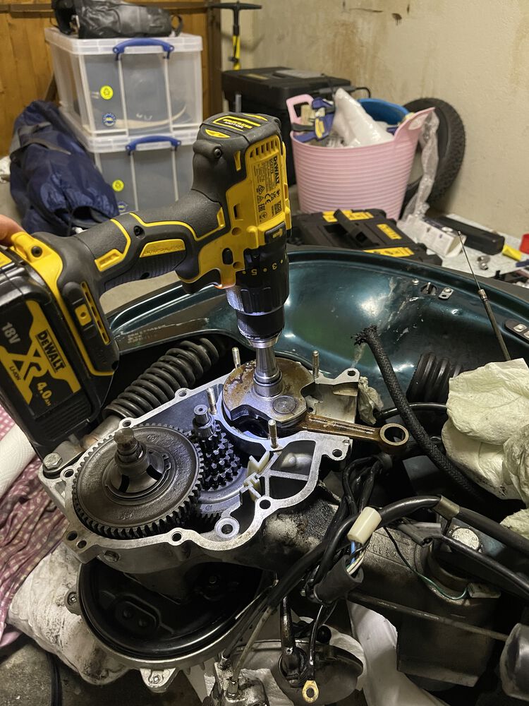

My friend who owns the garage arrived with his toolbox from Ireland today so I finally got the nut out in two pieces. Took a small bit of time, I drilled two 6mm holes in opposing sides and then chased the nut out with a hammer and a punch. Not elegant but it worked. Excellent! I do have some more stripping to do though to make sure no swarf got into places where swarf shouldn't be.
The crank seal was in an awful condition, it seems to have melted the seal and the spring has definitely wrapped around the crank. I have all of the new gubbins to replace this stuff anyway. I haven't tipped the bike over the other way to see the damage on the rotary valve pad, I felt it with my fingernail though and if it had been paintwork it would definitely be the damage that needs a respray. Should have another update tomorrow.
I've also found that the stator wiring is quite old and all of the insulation is cracking and falling off. If I was at home I'd solder it but for the price of a soldering iron here I may look into a new stator and or performance flywheel.
A side note, the crankshaft nearly fell out when I tapped it with the hammer. A bit concerning. I haven't built a 2 stroke before but I don't think bearing clearances should be this loose for the crank. Anyway, new bearing and crank to be installed so once the case is good I should be fine.

@mjrally avatar
Posts: 5356
@mjrally avatar
Posts: 5356
Definitely shouldn't be able to tap a 200 crank out without some real effort! Need a pusher/puller tool so it draws in straight and doesn't take the crank out of true.
For the future, an old member Rob Hodge showed us a trick to grind down the sides of the clutch tool so it sits deeper and doesn't slip. Definitely worth doing to yours.
Stator rewire kits are available on the market for cheap. Just redo the solder joints and done. Cheap insurance so you're not chasing electrical issues down the line. Lightened flywheels are always good fun.

I would have ground out the socket but I have access to basically no tools here. I'm working abroad at the moment and when I started this project all I had was a 1/4" socket set. I don't particularly want to buy too many tools here because they are poor quality and very expensive and then I have the issue of bringing them home with me.

Better to change this castle nut to original one.
Or this DRT one.
@safis avatar
Posts: 5334
@safis avatar
Posts: 5334
Or this DRT one.
1st gen Cosas had a 7 spring clutch so the later nuts will not fit…

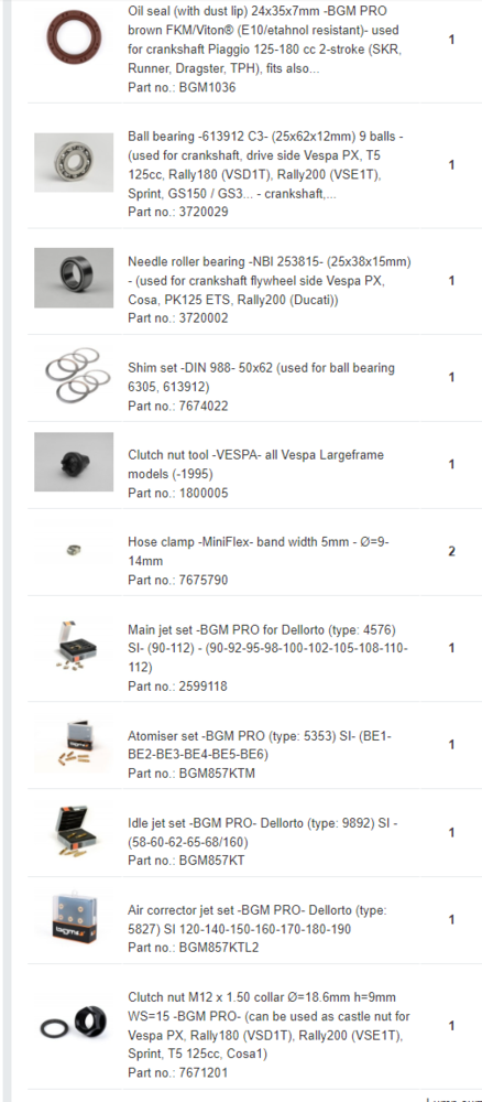

I've bought a BGM anodised nut for it so that should sort any problems there.
So I got the scoot turned over on its side last night to inspect the rotary pad…. It doesn't look good.
The black bits in the scoring caused by the oil seal ring I thought were just oil, after some cleaning with brake cleaner the marks in some areas were not shifting.
I think it's part of the oil seal in the second picture which appears to have melted.
The third picture is the damage nearly all cleaned up. I used a small knife to get 99% of the rest of the rubber out of the grooves.
Finally I used the chemical metal to skim over the pad. It's not going to be perfect but until I find someone to build up the pad again I will settle for better. I will install the crank when I get back next week and check the clearance once I'm happy the material is smooth.
Rotary pad
Rotary pad
Great tip.
I mountedw on my mk.I 6 springs clutch that DRT nut. Is this means that it will fit to Cosa mk.I clutch?

Smokey Bear wrote:
Rotary pad on my P150X looking worse than yours. But it works good. Only problem that it sometimes won't start from first kick when engine is hot, need 3 to 6 kicks.

Got a little warm in there?

Yeah that seal is like a melted welly. I'm not even sure how that can happen….
I had let the chemical metal dry over the weekend. It had some high points so I put the end of the old crank in a drill and spun it for a while. This introduced a few of the small gouges back in but now it should have the proper clearance in general without any of the very deep gouges from before.
The new bearing tapped into place pretty easily.
The next job is to freeze the crank and heat the needle bearing race. I brought them home so the crank can spend 24hours freezing and I'll put the bearing in the oven. 200 degrees and it should fall into place easily.

That crank oil seal getting mangled and damaging the intake valve was a ton of bad luck.
I had very similar damage on my rotary pad. I soda blasted it to get the gunk out of the grooves, followed by JB weld to level the grooves with the undamaged parts of the pad. I wrapped a feel gauge with 1000grit wet/dry to make it smooth. Even before I repaired it, the scoring on the pad didn't cause any issues, so you should be ok.
