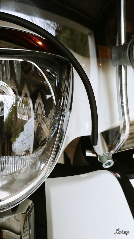

Faco Medium windscreen and closeup of the bolt fitting into the expansion plug.
The Faco mounting is much easier to mount and adjust than OEM.
Edit: This is close, but I still need 3.5 more inches height to be perfect for myself. I'm now considering the Givi Airflow Blade instead of the little deflector at the top. No sure what I'll do yet.
Medium Faco GTS screen on Piaggio Liberty
Close up of bolt going into expansion plug

Tinkering a bit more. The windscreen was tilted back and I thought 'Why not straighten it up?' So I curved the mounting post a little. Put the bend even with the headlight (bent top to the right as shown in the photo)
ALWAYS check the turning of the handlebars after mounting the Faco(before riding) because the expansion bolts will hit the leg shield if not pushed all the way back (Thank you Robot). Rubber mallet or the wooden end of a carpenter hammer works. Can hear the difference bumping it when it is fully seated.
Took it for a ride. Put the air stream up from my neck to the brow of my helmet. Even though it is daylight, I could still see the headlight on the outer edges of the screen. I put auto door edging around the bottom edge around the headlight. Reduced it about 80%, and doesn't glow as bright as before.
I also ordered the extension but not sure if it is needed now. I'll also experiment with it. This midsize screen seems to fit well and looks better (to me) than the tall screen towering up high.
Bend mounting post forward.
Beware of expansion bolt

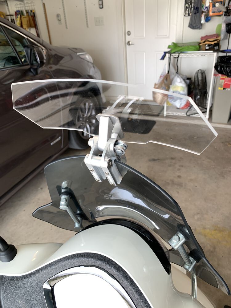

In lieu of a bigger windscreen, I added a $25 deflector to try out.
The bracket is pretty solid, and is quick release adjustable for height and angle, but the deflector part is a just lightweight piece of acrylic which should be easy to reshape.
The way the deflector attaches to the bracket lends itself to swapping out the piece of acrylic with something a little bigger.
I'll report back after running it up to speed a few times, but the next few days promise cold/freezing precip.

Update on the wind deflector.
I rode around today for an hour, city streets at 35 mph and rural highways up to 65mph (indicated-don't have my phone mount yet for a true GPS test), and the deflector creates a dead space from eye level to waist, and pushes the wind out to hit my outer shoulders.
Still some buffeting at the top of my helmet, and not noticeably quieter, but a lot less pressure on my chest and head.
I played with the angle a bit while at steady speeds, and found the near vertical position to have the greatest effect.
I had to snug up the mounting and adjustment screws a bit once I got home to keep the wind at highway speeds from tilting it back.
