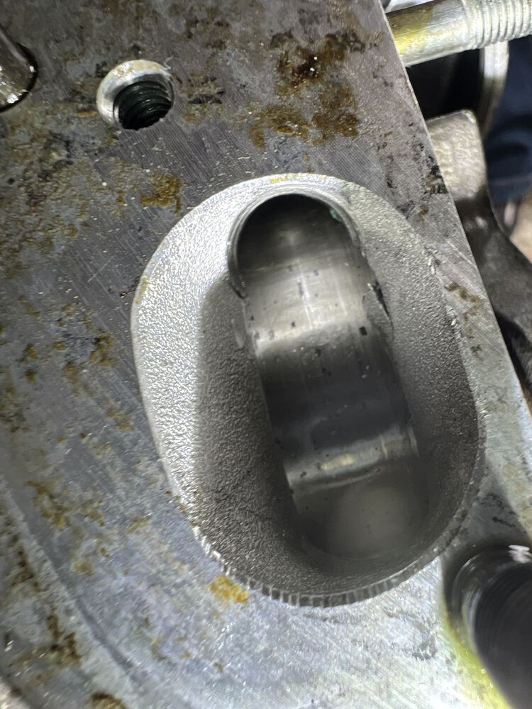

The rotary pad on my p200 is pretty scored. Wouldn't know it though from how it went down the road or carb spitback. It ran just fine.
I'm not sure how accurate the feeler gauge method is for ruling out a bad rotary pad. I think the leak test (filling the closed rotary valve with 2t and seeing how fast it leaks through) might be better. Annnd…how does it run or is there spit back?

That pad would clean up just fine with some JBWeld, too. My VBB's motor looked worse than that when I opened it up. I agree that the leakdown test is the real measure.
It's also worth considering whether the scoring runs the entire length of the pad or not. If it doesn't then it'll still be sealed for most of the time the valve is closed, and is de facto just extending the port timing a little.

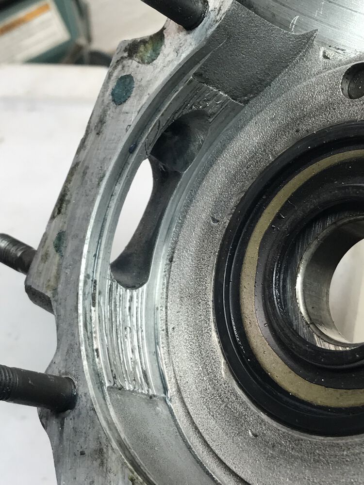

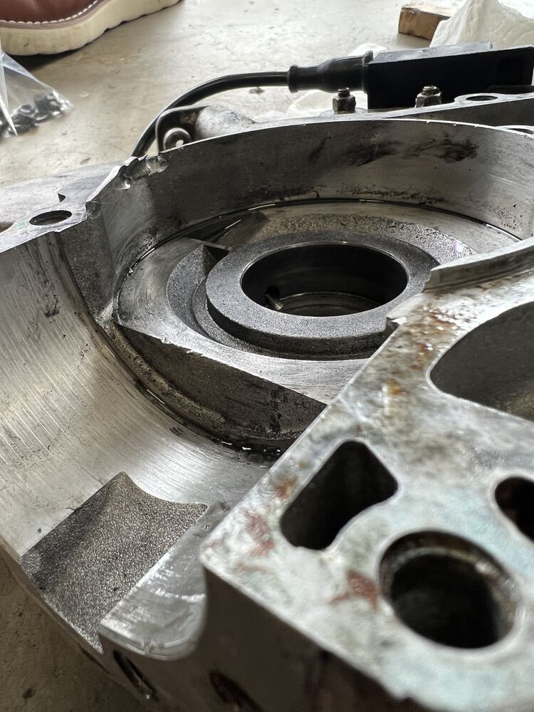

Pulled the flyside half to investigate. Enough damage that it needs repair, but nothing that's the end all. Gonna price out repairs vs new cases. Owner is happy keeping it stock.

That doesn't look too bad. I recently found similar gouges in a set of project VBB2 cases that I have -- but only in a few spots in the crank recess area and not on the rotary pad beneath the intake. I decided to experiment with the legendary JB Weld and razor blade fix technique and it seems to have worked well. I acetone-cleaned and heat-gunned the cases majorly before applying it. It's now cured for more than a week and it feels smooth enough to go for the full engine rebuild soon.

That screw damage on the lip is going to be tricky. You can fix it with JBWeld if you let it set up a little bit, then put a piece of plastic wrap sprayed with mold release, anti-spatter, PAM, etc. on it and close up the cases overnight.
I did it to the Smallstate 1.0 cases on a much worse screw-up than that and it sealed tight. For a while.

I'd do that for my own, not for a customer.
