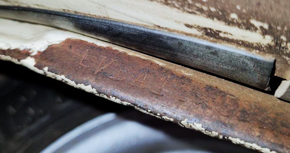

https://scooterhelp.com/serial/ves.serial.numbers.html
Your frame # doesnt come up.
Engine number comes up as a 1959 model.
Like Voodoo said, with a 20/17 it is not piston ported (unless it has a weird, non original manifold connector of some sort.)

WOW, wasn't aware of this tool and this certainly clears a few things.
You're right, the engine number shows up as 1959 and I went and took clearer (not that great, I know) photos of the chassis and it seems to be the same as the Engine number, i.e VBA1T and then I can see a 5 (So, assuming that the chassis also shows up as a '59). So, my registration card has the wrong chassis number printed on it. I don't know how that happened along it's ownership but, I have attached some pictures of the chassis stampings.
Would appreciate if you think everything is as it should be or not.
*I have also changed the title to '59 from '58 to avoid confusion for future reference.

Thanks for the pics and good sorting on the frame number.
Those serials are close in production and indicate a nice original machine.
