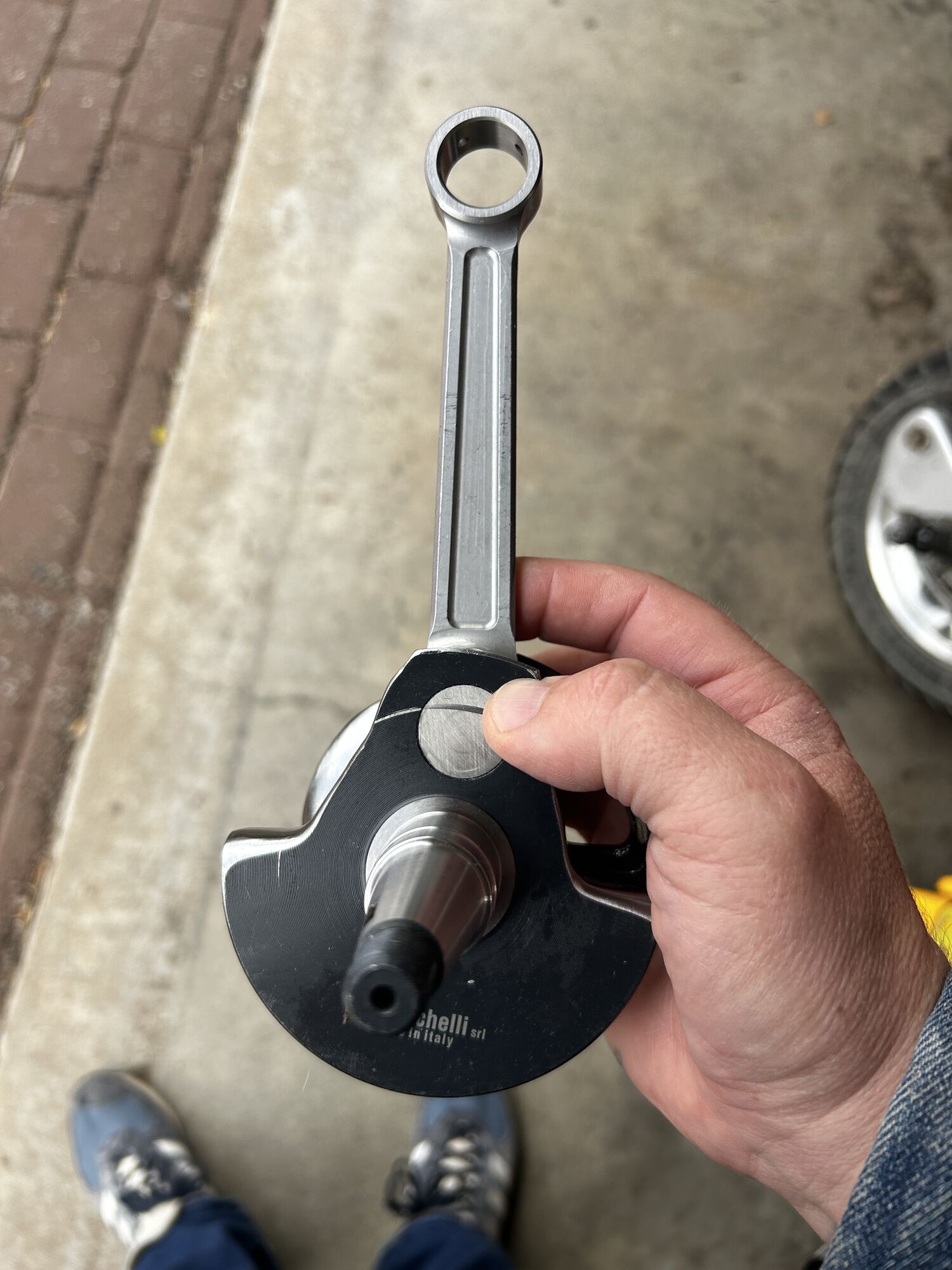

FINYoshi wrote:
Would this crank be good to go with VMC 244 on VR-One cases?
https://www.sip-scootershop.com/en/product/bell-shaped-crankshaft-sip-performance-uncle-tom-for-vespa-200-rally-vse1t-33997-p200e-px200-e-lusso-my-cosa_45022700
Currently I'm running this with Malossi Sport cylinder:
https://www.sip-scootershop.com/en/product/bell-shaped-crankshaft-sip-premium-uncle-tom-for-vespa-200-rally-vse1t-33997-p200e-px200-e-lusso-my-cosa_45022500
Was also thinking of swapping only the conrod to a longer one, but the rod alone is over 200eur.
I'm using the first one with the Quattrini 252 on VR One cases. No issues at all, it's been a good crank for the last 4000km. But the case needed to be spindled to fit it.
https://www.sip-scootershop.com/en/product/crankcase-sip-performance-malossi-vr-one-for-quattrini-vmc-bfa-244-for-vespa-p200e-px200-e-lusso-98-my_57172452
Sip sell these cases pre spindled out; for those put off by the machining, I'm sure it's a game changer.

I think the VMC 244 design and thus recommendations are aimed towards the most common setup which includes stock cases and rotary intake. I think 60mm stroke is the most that you can get reasonably with rotary intake.
My cases have already been spindled so I'm positive that the crank will drop right in. Also for what I've read the VMC port timings are really on the conservative side so packing the cylinder up a notch should not make them too high.
Order for cylinder kit and crank is now placed.
