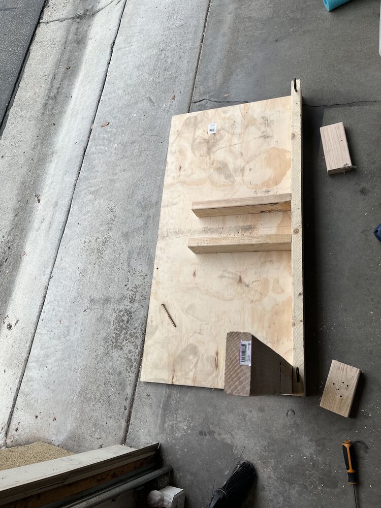

Also why do you have to remove the rear wheel to do a valve job?

"Also why do you have to remove the rear wheel to do a valve job?"
You don't if you have a way to lift the scooter up high enough to let the rear of the engine/CVT case drop down far enough. You do have to unbolt the rear shocks to let the engine/CVT case pivot down. I didn't want to try and jack the scooter up that high, because I was afraid it would fall over. Also, I was replacing the rear tire anyway. I tend to get about 6,000 miles out of a rear tire, and on my GT200 the valve adjustments are every 12,000 miles (every 6,000 miles on an HPE) Removing the rear wheel gave me several more inches that I didn't have to jack the scooter up. The cam cover on a GT/GTS is very close to the frame. To get the cover off and get to the valve adjusters you need let the rear of the engine/CVT case pivot down, which gives you enough clearance to get the cam cover off.
Many Asian scooters have a removeable panel down below the front of the seat that gives you access to the cam cover, but Vespas don't. Removing the rear wheel gives you several more inches that you can drop the engine/CVT case/rear hub down.

I have an easier way to drop the rear wheel. My lawn is about 2 inches lower than the patio, so I put a few bricks on the edge of the lawn and wheel the scoot out so rear wheel is on the bricks, then put the scooter on the center stand and remove the bricks.
Posts: 11497
Posts: 11497
Disconnect shock and use a reversed clamp to push the engine and frame apart.

Vintagescooterdude, Znomit, Nice workarounds!
I work on the ground as well but got the little scissors jack from scooterwest that works really well along with my DIY front wheel chock (it also doubles as a workbench top)
