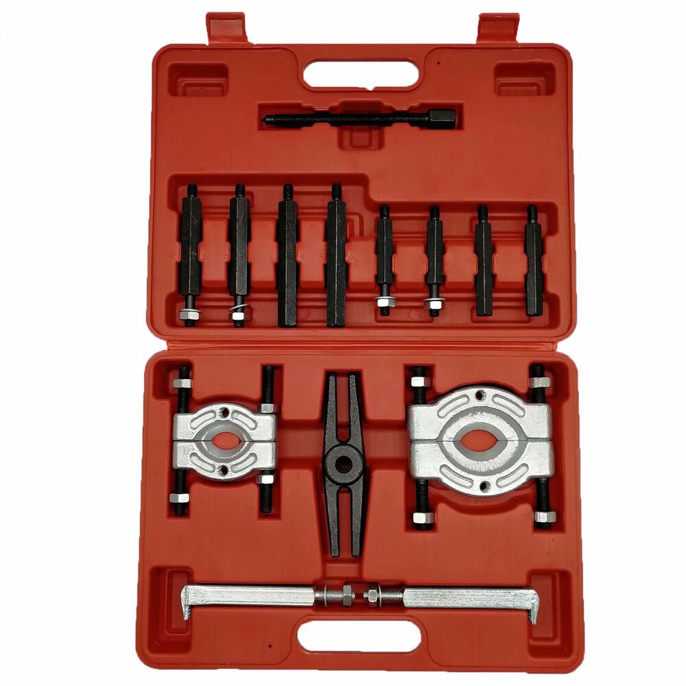

Hi guys. What tools have you used to remove the ring off a Vespa crank. I've found all sorts like 3 leg bearing tool and others but not sure what to get. I know about tools from sip and others scooter supplies but I don't really want to pay that much money

Something like this will get the job done.
3 leg won't work, not enough room for the jaws.

not the same bearing, but I use the same set up for both.
UK's version of Harbor Freight is Machine Mart I think? maybe something from there? or just ebay it!
