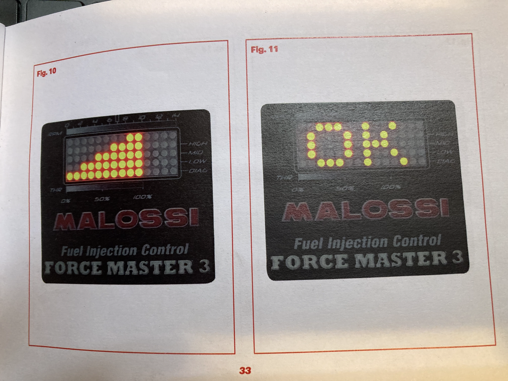

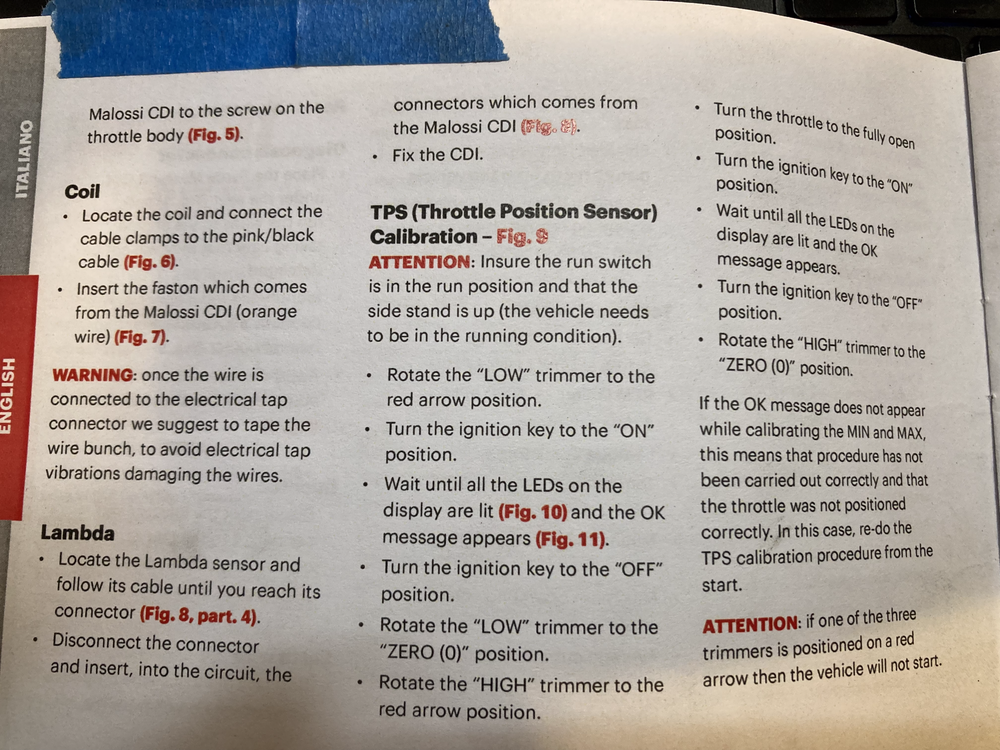

Hey gang,
Anyone else install one of these?
I put mine in the other day on my 2020 Sei Giorni HPE.
Cables are all hooked up correctly, however when I follow the calibration steps for the life of me I can't get it to follow the actions in the book.
I can only get an M0, for Map 0, which it is set to. I can't seem to get all the lights and the OK when I turn it on which the manual says should happen.
Is that map pot/dial meant to be set to something else when I start it up? The instructions don't mention the setting there and it comes set at 0.
Am I doing something wrong? The Vespa does start up and it does run. I've followed the low and high calibration steps, I just can't get the lights to do what the book says they should do.

This is what I've got.

That one is significantly different than the one that came with it.
It does not appear to contain the steps I am having trouble with.
I'll try the steps in the manual you provided and see how it goes.
Thanks a lot!

Okay, it seems that the forcemaster 3 follows the behavior exactly as the pdf from the website describes, and not how it is described in the physical copy!
Thanks for the link! Thankfully, it appears the installation matches, and it's a few steps that have been eliminated in the calibration which makes the whole thing simpler.

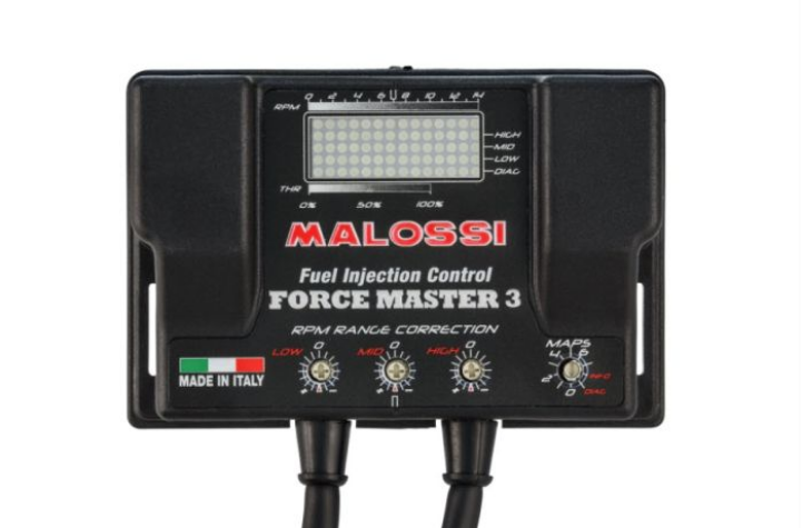

What is the part number that came on the box?

M5518480 also on the physical copy
pdf says M5518992.
Sticker on the back of the forcemaster says 5518481
