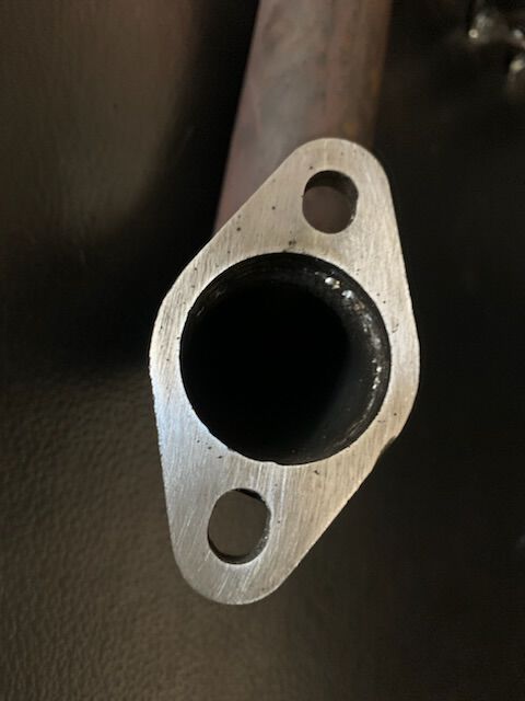

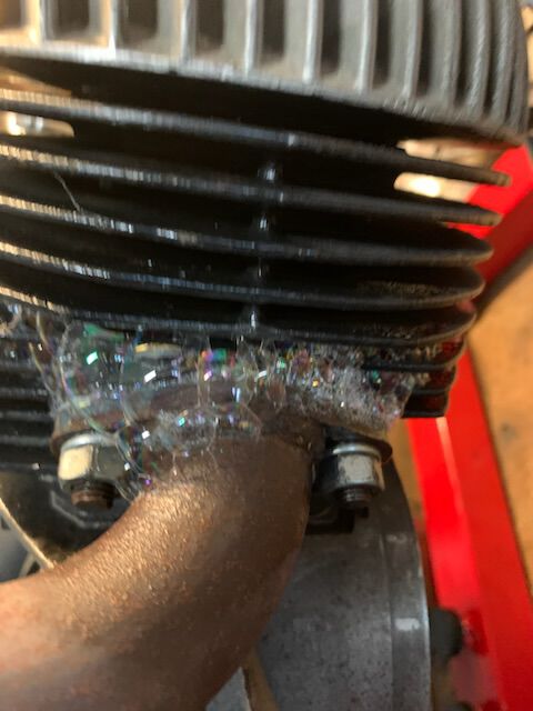

Got a PM pipe on a Polini cylinder and can't get the connection airtight with a regular exhaust gasket.
Both surfaces are straight and clean. No leaks at the studs.
Looks like maybe the pipe needs a copper donut type crush gasket, but I can't find any that fit.
What are you guys using?
Think we found the leak
Pipe flange
Pipe flange

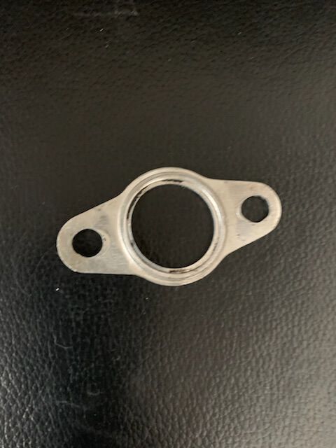

Gasket that doesn't work

People on the forum have recommended copper gasket dressing for this application, along with a lock washer and maybe an extra washer, and maybe loctite.

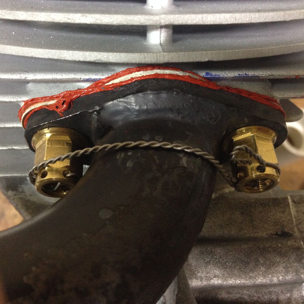

I think I just used a little bit of RTV red on my smallie's cylinder to flange.
The flange-to-exhaust uses an almost spongy metallic foam gasket. That thing is awesome and if you can get some of that material, I suspect it'll solve your problem nicely.

I second the red RTV
I also made some bronze nuts and safety wired them.

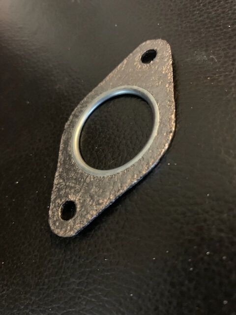

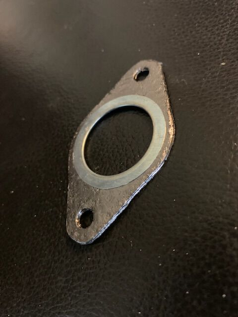

New exhaust gasket going on (couldn't find a bbq beef box, so settled on this).
Does the flat side face the cylinder or the flange?
I also want to know the answer to this question. And where did you get this gasket?

Looks like Dario puts the flat side on the cylinder @ 23:45
It came in the Scooterwest "deluxe" smallie gasket set, along with two others.
https://www.scooterwest.com/small-frame-gasket-set-vma2-vmb1-153509.html
