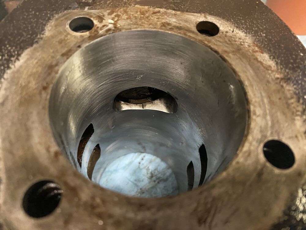

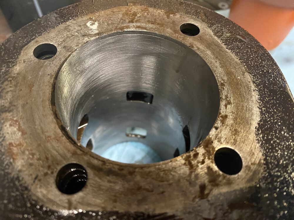

mannn... that looks pretty rough.
I'd clean it and the barrel up and reassess.
for your riding needs, a well tuned bone stock bike with some tasteful upgrades will be more than sufficient. personally, I'd forgo a malossi kit and throw that dough at other items.
you're kind of in a pickle here. you're probably going to need a top end. and as such you'll want to match your crank to that. but you don't necessarily have to go that route, it's just that it all works so much better if you do. for example, for the malossi you want a 60mm crank but it will work with the stock 57mm crank. conversely the stock 57 with a stock barrel is fine, but with a 60mm crank it can work better, you just have to do a little more set up.
then there's the top end. a stock top end is gonna run you about 200 bones no matter how you slice it-- off the shelf, or on a next over, vs a malossi is 400 give or take. or maybe you source a take off or used aftermarket kit for a bit less.
so it comes down to how, where and when you want to spend. build a bomb proof bottom end with an eye toward future upgrades or knock it together stock with the understanding that if you want to go hotrod down the line you'll be spending that money then.
personally, given the intended usage, I'd stay stock-ish. if the crank is fine, re use that. if the top end can be cleaned up do so and run it. that's easily changed later.
a well tuned stock 200 with a 20/20 and a cosa clutch and a SIP2 would be a more than capable commuter and easily hit that 45mph and cruise comfortable at 55

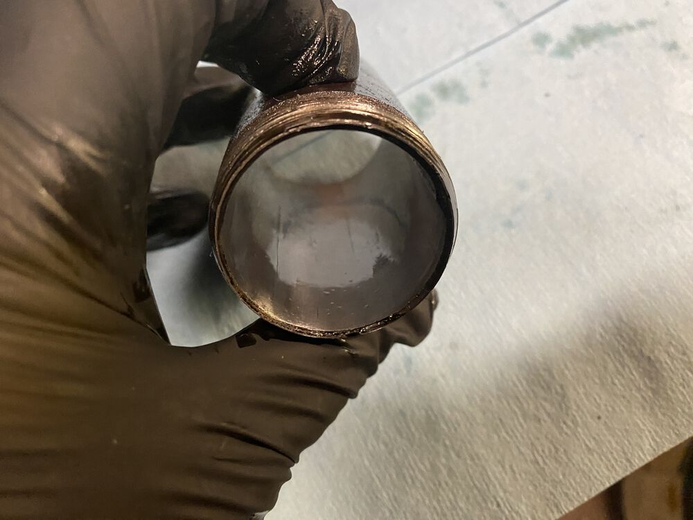

I'm considering it not great not terrible, found a stuck ring so fixing that might bump up the compression a bit more. Ultrasonic cleaner should make quick work of everything, the head looks brand-new already.
$200 to replace like-for-like feels meh to me, that's shaping a bit of everything for my decision process, makes the Malossi feel like it only costs $200. I'd like to have a plan ready to go when the current cylinder dies my by hand or its own regardless. Anybody have a stock matched piston and cylinder from when they did a cylinder upgrade?
I've done a similar thing on a few Spitfire engines, rebuilding the bottom end nicely then sort of cobbling together the head and reusing a slightly sketchy cam, as replacing those is only a 3-hour job. Get 20k or so miles out of my shadetree valve job, then drop 1k in machine work and parts to get another 7hp (out of 80 total...)
Quite a pickle indeed; I have a feeling the 60mm stroke crank would cause that cylinder to die quicker, but I plan on that happening anyway. Maybe that decision will be made for me if the stock one is shot. Seems like I should just get on cracking the engine open and find out.

The older cylinder castings were nicer than the ones you can get now. So, you should send me that one and get a kit.
Or you could get an oversized Grand-Sport piston and have it bored.

I mean, this is not an unreasonable argument... (even the sending you the older castings)

I think that you're on it-- not great, but not terrible. run it till it pukes and then make a choice.

+1
Get it running and riding as cheaply as possible. Then decide.
With the cylinder off, you will be able to see the worst of it. Angle the engine back and fill the crankcase with petrol. If it holds this level and the crank is not rusty, there's no need to split it just now. Once riding the gearbox might be shot but that's for later. Also possible it was last running without autolube/2 stroke oil.

Some things to consider: How soon do you want to get it on the road? Next consideration is how much time to you have to spend on it. Budget seems to be less of a consideration for you which is always helpful.
Doing the basics to get it running is fine if you are just taking it for ice cream. This approach hasn't worked very well for me as it results in more time and work in the long run and doing the same work many times over. I would rebuild the engine, pressure test and get a reliable close to stock engine going. The GS piston is a good upgrade. Ultimately, it will be reliability and not top speed that will make it a solid commuter. In some ways it's a more demanding application than building something that will tear it up on the way to the 7-11.
I have one rideable bike and one that is a nuts and bolts restoration. The restoration is much more enjoyable because I already have something to ride.
For me, the parts for an engine rebuild and a decent kit start to get into real money, so blowing up an expensive kit would be quite a setback for me. This might be less of a consideration for you, so take my comments with a grain of salt.
