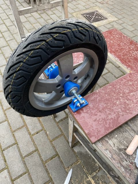

Bought new City Grips II last week. Tire shop was able to mount them on the rim, but were not able to balance them. So I balanced them on my yard:-)
Model downloaded from the thingiverse and printed on my brother`s 3D printer. I just bought 4 bearings, and found a piece of the rod in the garage.

That's really fucking cool.
Was this the one you used? https://www.thingiverse.com/thing:2475245
Gonna be a lot cheaper to buy send it to the local print shop while I go buy a couple bearings than spend $$$ on a Mark Pines balancer.

Used this one https://www.thingiverse.com/thing:3454748 There is also description of bearings. I bought the cheapest ones and whole 4 pcs costs me aprox. 5 USD

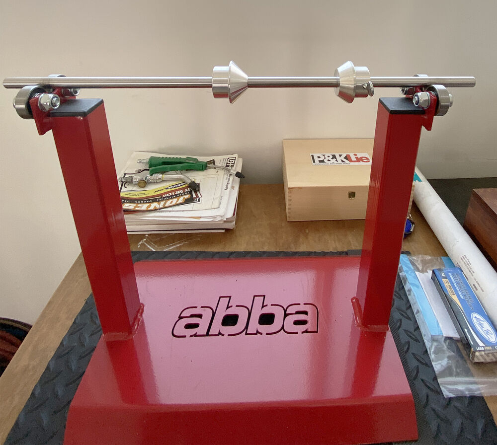

I recently bought a Vespa wheel balancing setup from Mark Parnes. I already had my own Wheel stand.
I found him to be a skilled machinist and his parts are a thing of beauty and quality and he is also very helpful.
There are cheaper and DIY ways to go for sure, but I appreciate quality made tools when I can get them.
where did you buy it?

...from MARC PARNES who is mentioned in a post above.

Very cool. Thank you.

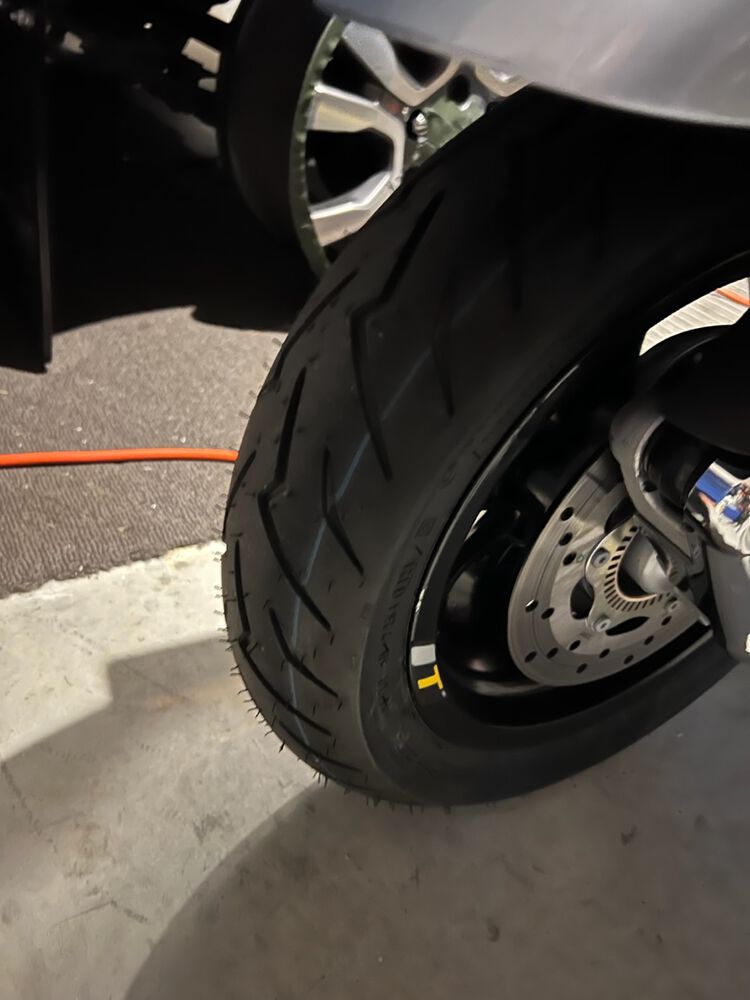

I'm running Diablo Rosso on my 2022 GTS with no weights and perfecto
That tool allows for static balancing. For dynamic balancing you need more complex tooling.
I do not know, maybe for the small rim wheels of a Vespa static balancing is enough.
For my BV 300 with 16 en 14 inch rims I want my wheels dynamically balanced.
The local Piaggio dealer offers a selection of suited tyres and has all equipment needed for dynamic balancing.
smoke and mirrors. pretty weird road racers at the tracks that go almost 200 MPH ride on static balanced tires.
