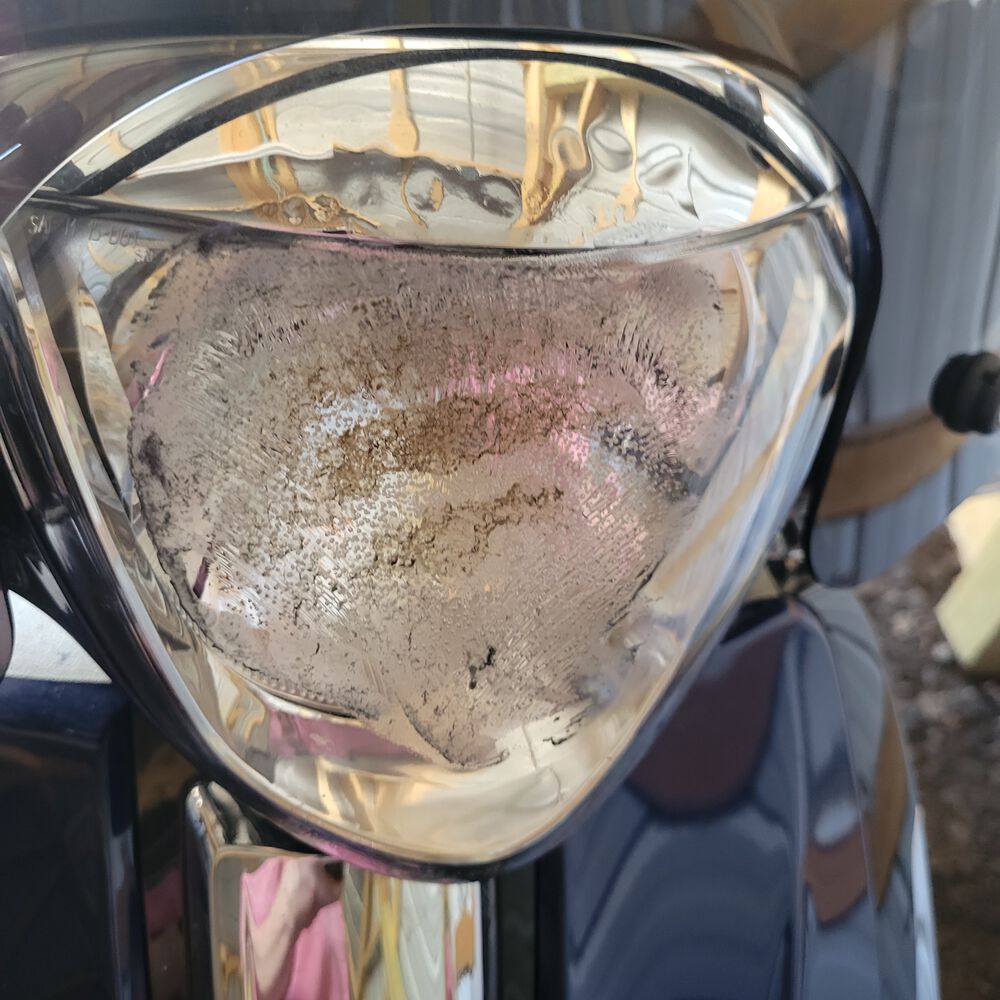

This is one of the lights.
There was a light sheet draped over each bike.
But the bikes were not running at all over the winter so I don't understand how this can happen
This does not look like melted but more like a chemical reaction…
Is that deformed or "just" blind? Is the upper, mirrored part wavy or is it just reflective?
What does the spot on the "light sheet" on the inside (where this was on the headlight) look like?

It feels ruff and melted and on one of the scooters the chrome above the light is bubbled up.

That does not look like heat damage to me. I'm assuming the chrome is plastic. did you have any kind of chemicals stored near the headlights? I don't know what caused it, but it obviously IS possible since it happened. Both my 2006 GT200 and 2009 Genuine Stella have plastic headlights, they never got melted, but they are not as clear as they used to be. My other 5 bikes have glass headlights. Plastic is not a good material to make headlight lenses out of.

It's not uniformly distributed over the plastic. It's in the middle where the heat from the headlight beam would be.

but the texture of the 'melt' looks like it's from the sheet. maybe that's the part of the headlight where the sheet was in contact
Posts: 11068
Posts: 11068
Look at the wavy pattern at the top.
Posts: 45144
Posts: 45144
And maybe the sheet was placed over the headlight immediately after switch off, when the lens cover was hot, and the bulb still had plenty of residual heat. I can imagine a thin plastic dust sheet going all gooey at the thought...

ah yes, I see above the line. jimc's comment about residual heat might apply for that part of the lens

My theory:
Hubby went out tinkering with the scoots without wifey knowing.
Thinking of the long winter and let them warm up a bit.
Now not only is his damaged but so is wifey scoot.
Hubby says nothing to stay out of dog house and tries to let her think it is faulty housing and that is why it happened to both.
This is a terrible design flaw and Piaggio should fix it.
I will take pics tomorrow and contact my dealer..
Thank you everyone for your input.
While it might seem like a design flaw to you, the only two Libertys this happened to were in your garage. If every Piaggio Liberty did this, due to a design flaw, there would be others that didn't winter in your garage that also looked like someone tried to clean the headlight with a rake. Something you did caused this, and if you don't figure out what it was, it'll happen again.
