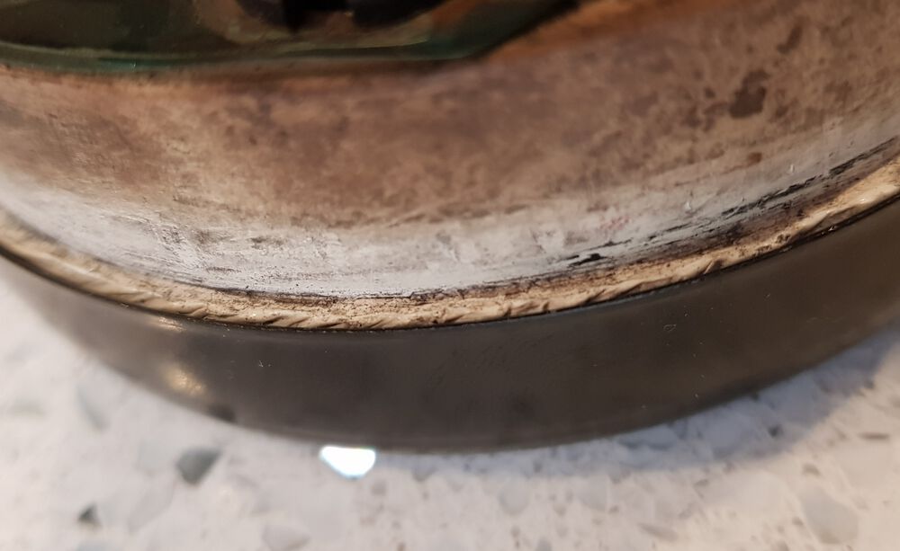

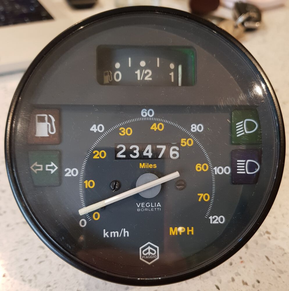

My PX ('87 EFL) got a little hot in our garage fire last year and the speedo lens melted. Once I'd removed the lens and rim, I set about replacing them both. Easy job I thought, but I can't think of a good way to bend over the lip of the rim. Anyone ever done this and done a good job? What's the secret to success?
The lip, including some smoke damage!

The face was mint under the melted lens

I took a scribe and drew a line about 2mm from the edge of the rim. Then I used a tin snip and made cuts every ±4mm up to the line. Once fitted you bend each section with a flat screwdriver.
It takes a bit of time, but the end result is perfect.
I have recovered many broken speedos in the past doing it this way.
I've used a scissors on thin metal like that also.
