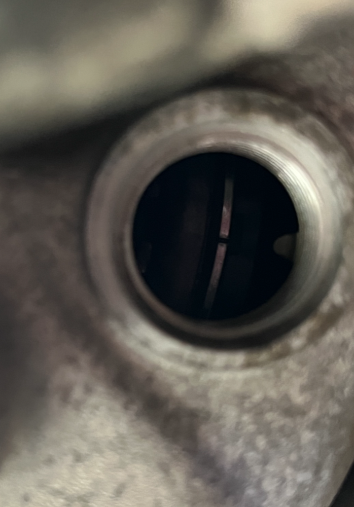

The scooter did came with another Throttle body. It's used also. I swapped it today and tried to programmed my keys but I could not get it programmed.
Can the throttle body then be damage or?
The brown key is the brains of the operation, the blue key as a copy. I'm thinking throttle body as it has the ECU in it.
a used ecu needs to be 'virginised' before you can program it. (discussed in other threads). or if it came with it's own keys (blue and/or brown) then just use those

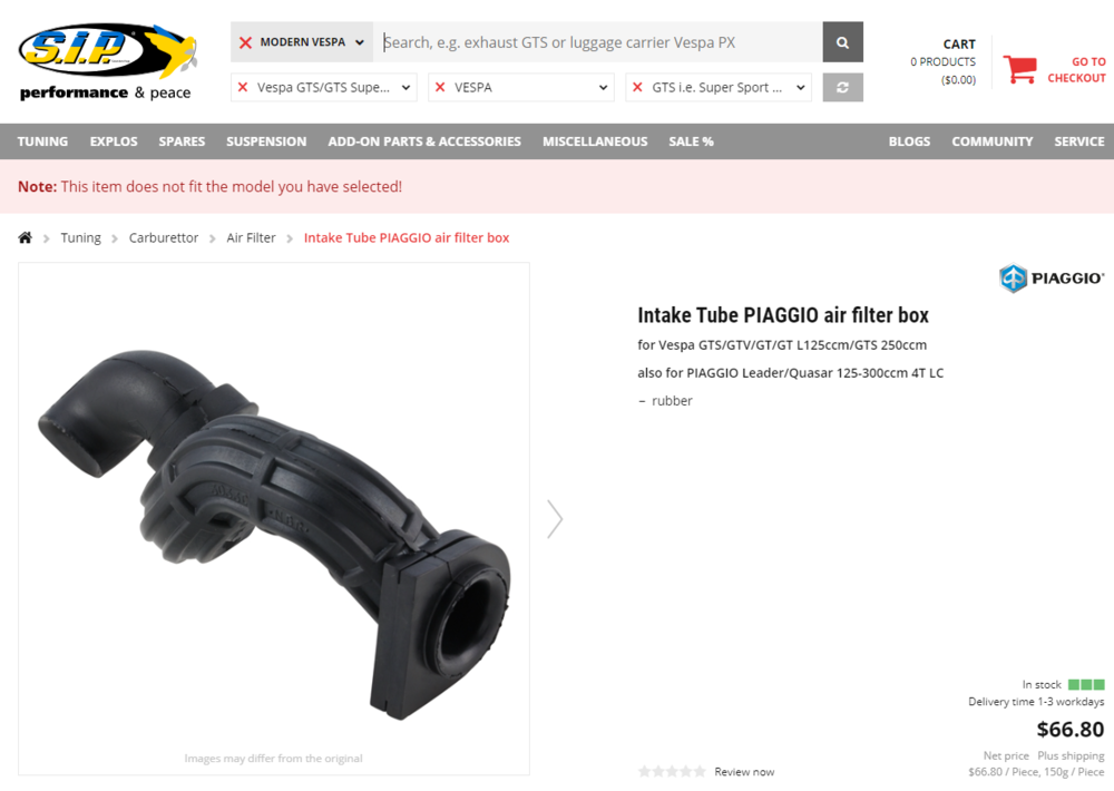

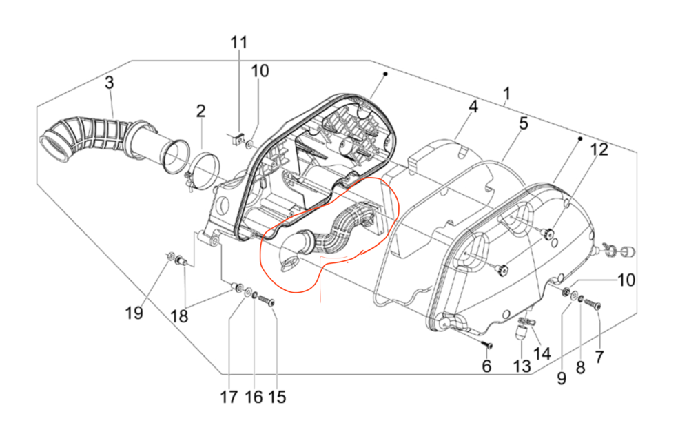

The marked part in attachment is missing from the air filter box
@germangtsdriver avatar
Vespa GTS 300
Posts: 1789
Location: Germany
Vespa GTS 300
Posts: 1789
Location: Germany
The marked part is SKU 844921. But it seems that this item does not fit a '2011 Vespa GTS 300 ZAPM45200:
https://www.sip-scootershop.com/en/product/intake-tube-piaggio-air-filter-box_PI844921
Assume that this exploded view is used for more than your vehicle type (this may the also the reason that it doesn't have a (clickable) number in your screenshot).
Please let us know your VIN-Prefix (first 9 digits) to check if ZAPM45200 is correct.

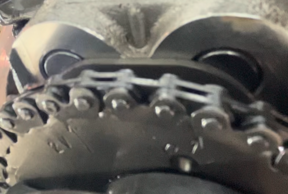

Then I think I found the fault
I have checked the timing of cam axle and it look to be 1 tooth wrong
First picture show that the 4V marking is not on the point it shall be, second picture show that the marking on opposite side on engine is on marking
Posts: 45827
Posts: 45827
Well found. Check the chain tensioner and the chain guides.

Can the chain go over a teeth or two by it selves?
What can have happen here?
Posts: 45827
Posts: 45827
Not if the chain tensioner and chain guides are in good condition.

I open the tensioner to day, then I was able to take the chain of the sprocket, moved the cam 2 teeth's. I mounted the tensioner again, turned engine by hand, everything seem ok. turned the engine on starter without spark plug, also everything ok. Then with spark plug. It started
I let it go a little on idle, before I run a short trip for just 200 meters. Everything work ok. I can't take a longer test run yet since I miss the exhaust bush between lambda tube and muffler.

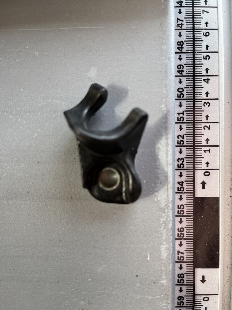

somebody know where this part should have been mounted
@californiacruising avatar
2015 Sprint 150, 2018 GTS 300
Posts: 894
Location: SoCal
Posts: 894
Location: SoCal
Spark plug cap bracket?
Yes, there it is...
Thanks
