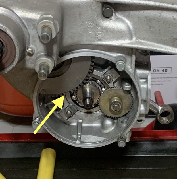

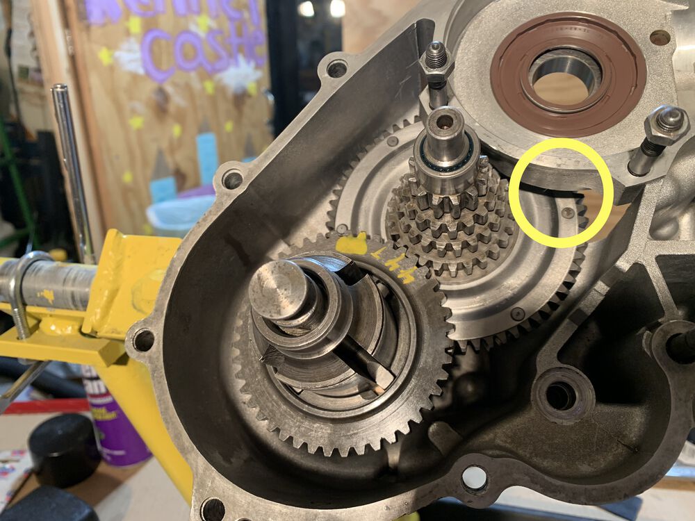

I listened to that video. What ever is making the tapping is rhythmic. The tapping sound speeds up with increasing RPM and vice versa. You mentioned you installed a Mallossi 34/64 up gear kit. Is it possible there is a rivet or two, on the cush gear cover plates, that didn't get peened down enough to clear the crank bearing?
I installed the same up-gear kit and had two rivets that needed a couple of additional smacks with the hammer to flattened them out more. Upon installing the primary shaft, I noticed it wouldn't rotate 360 degrees by hand but seemed to be hitting something. I found an offending rivet which was contacting the bearing. See yellow arrow. I reversed the rotation and found another rivet that was contacting the bearing. I ended up peening all the rivets again until the primary could spin freely and all the rivets cleared. Maybe you just have a rivet that is grazing the crank bearing? You may be able to feel it by rotating the engine slowly. You may also be able to see a rivet with wear marks on it if you remove the clutch and use a small inspection mirror.
Running out of ideas.
Hec
Rivet head on opposite side was contacting crank bearing.
Potential culprit?
Potential culprit?

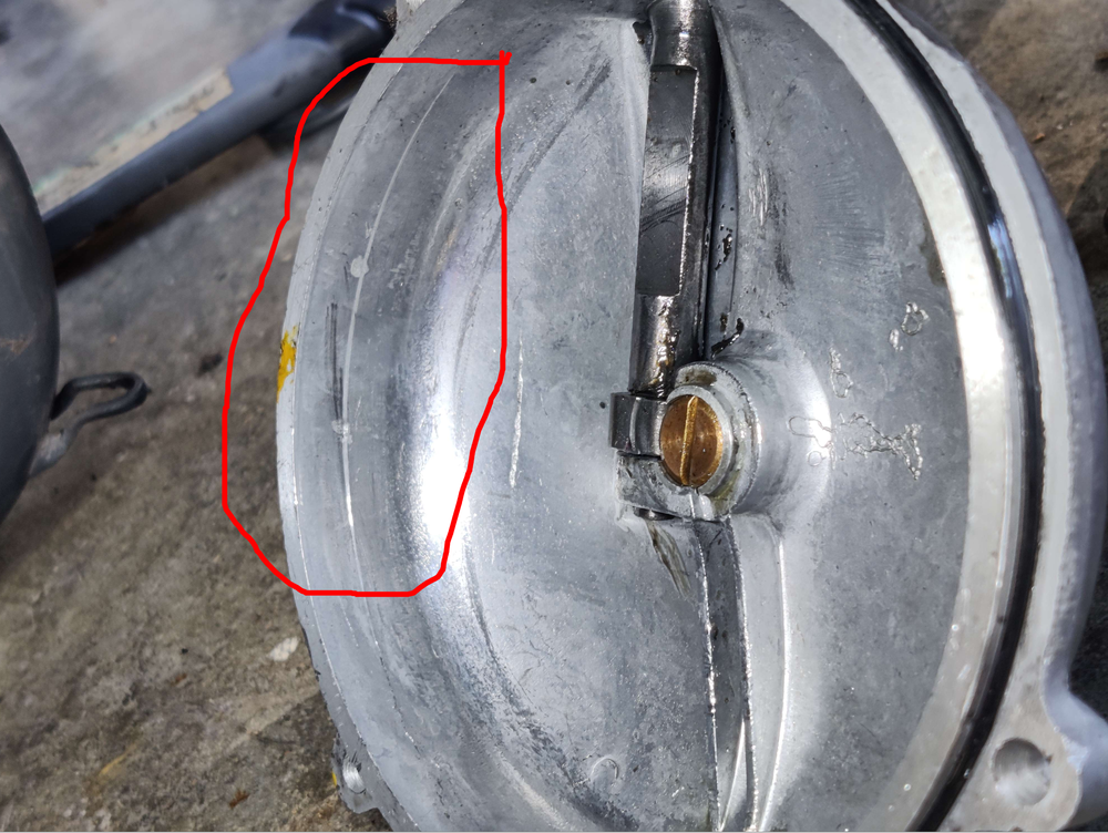

Just popped off the clutch cover. I could see 1 score in the side but I don't remember if it was there before the rebuild or not.
I ran the engine for a few seconds to see if the clutch contacting the cover was the source of the noise, and the noise was still there. Next I want to try running the engine for a few seconds with no clutch at all. I want to rule out everything before I have to split the case again to diagnose this issue.
