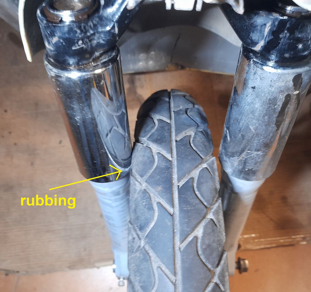

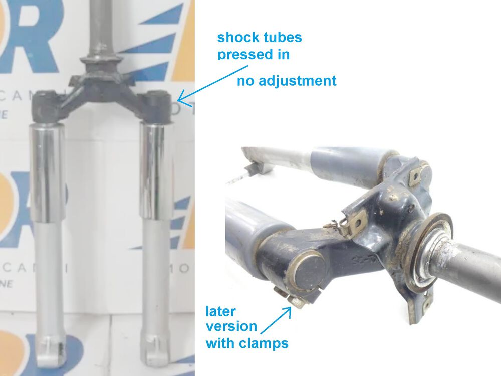

I bought a 2002 liberty with front wheel misaligned, i guess from some crash. The tire is rubbing the shock. The shock tubes are just pressed in, there is no adjustment possible so i guess the fork cant be fixed.
Perhaps somebody knows can i buy later style forks with clamps to hold the shock tubes?

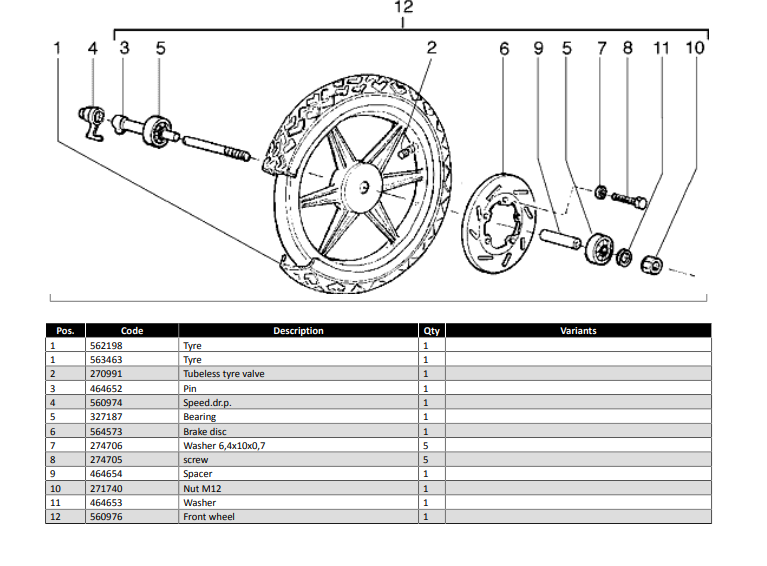

Was that wrecked bad enough to take out the front fender. Why is there so much slack in the axle? Is there a nut on the left side, and is it tight to the fork? Have you had the wheel off? Maybe you're missing a spacer... #9 in the drawing.

I know nothing about the crash, the seller said the scooter just felt on its side, but who really knows maybe he bought like this himself because he owned it only a couple of months. The scooter was very neglected, eg sponge air filter completely gone , but the price was right obviously.

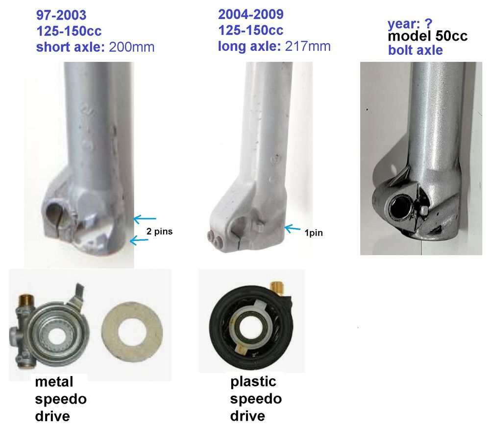

There is a spacer, and the axle is straight. Its loose only when i was taking the picture. The tire is rubbing the right shock tube, and there is no way to adjust that. Have to buy a new fork and hope its only this.
Anyway i found out 2004+ models have a different speedo drive mechanism, thus different fork attachment and the wheel must be different too. So ideally i need to buy a specific fork for my early model. Or buy newer one and somehow modify it to my speedo drive. I assume the axles are the same.
