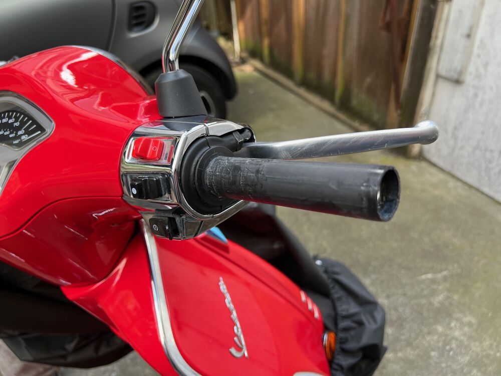

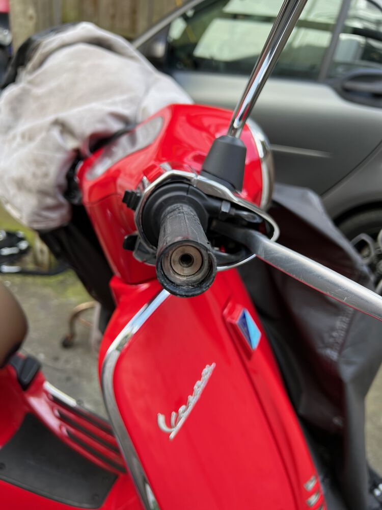

There is no grip on the throttle side presently, and the throttle body seems not-overly-pushed-in.
Here are two videos showing the issue:
https://youtu.be/E8eQsTXyRbQ
https://youtu.be/Wg3_6AmePAw
And two photos below.
Thanks,
Adam
throttle body
throttle body
throttle body, side
throttle body, side

From the bar end photo it looks like the plastic on the throttle tube at the 2 o'clock position is cracked and bent inwards? It may have deformed the plastic throttle tube during assembly and is now dragging on the handlebar.
I'm assuming it worked fine before the grip install attempt. Backtrack to last know good position! The throttle side grip has a slightly larger inner diameter to compensate for the throttle tube diameter. Any chance you accidently tried installing the left grip on it?
Try spraying some brake clean or similar between the throttle tube and the bar. Flush it as good as you can. You may have some gunge in there that's causing it to drag. Even WD40 will work at least to see if that helps improve it. You may have to remove the tube and see what's going on in there. It wouldn't hurt to lube the push-pull cables also.
