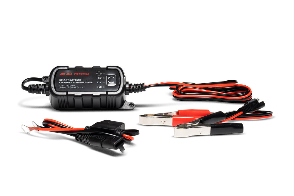

I just saw that Malossi sells a battery charger & maintainer. I wonder how many more HP it would give ROFL emoticon
https://www.malossistore.asia/en/battery-charger-smart-battery-charge-mantainer-6v12v-1a-for-batteries-from-2-to-20ah-4419240-P
