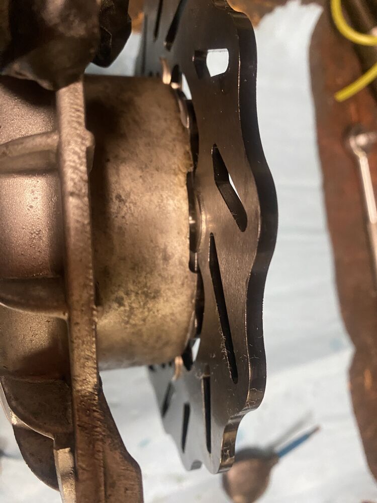

You will have to machine the drum to fit. I do them here, but you may find someone local.
Floating disk conversion on LML Stella
⚠️ Last edited by GickSpeed on UTC; edited 1 time
