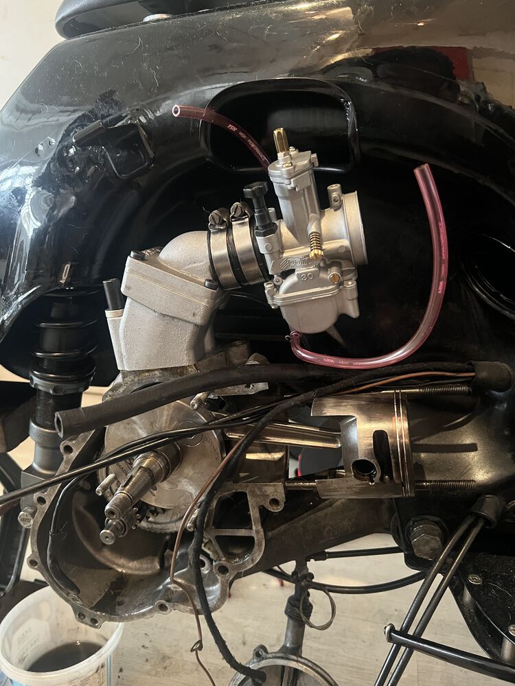

Jack221 wrote:
Always surprises me how guys build a tractor engine, then do everything they can, spending weeks on end, trying to make it go faster. Why not just build a fast engine. An MHR with the same effort and budget would be 10bhp more.
So, for a start, and to be clear, I haven't started to make it go faster yet.
What I wanted was something that was fast out of the box. Once I have run it for a year or two, then I'll probably want to upgrade the carb and pipe, maybe lift the exhaust? But all that is open to me at the moment. Aside from the Uncle Tom crank it's 'stock' Quattrini. And I wanted the Uncle Tom because it's not full circle like the Quattrini crank.
If I'd started with an MHR and built a bit-over-30-hp motor from it, the mucking around, big carb, expensive pipe would have been much less straightforward and probably not all that different in cost. Then, in a year or two down the track, where do I go then?
What you have built is great. Going to cruise really well and have plenty of torque. It will do 75mph , maybe even 80mph. Will be a lot of fun to ride for many years.
With the 62mm stroke and very long rod there is a much lower rpm ceiling. So any future tuning needs care.
Concerned your mix screw is in too far. Typically on a 55 pilot, even with an AS268 it ends up over 2 turns. Any sound recording while adjusting?
Good to know. I realise it's on the dyno so not real world but I saw in the SCK 252 series that the Polini box peaked out at 10k-ish. I guess you're saying that it's unlikely to last long at those revs?
Anyway I prefer torque over high revs so should be good.
No I haven't thought to record idle adjustment, I'll do that tomorrow if I get a few minutes free.
The extra jets turned up today so I took it out on a test run. I had the X32 on second clip, the AS264, dropped the pilot to a 50 and started with a 180 main.
High idle was still around 1.5 turns out. Drop it further again?
It felt good, not quite as smooth a cruise as I'd hoped (tried the needle back on the first clip but only made a small improvement). But anyway, even without pushing it it pulls like a train. Hard to hold back!
The 180 flooded at 3/4 (probably, it was dark) 170 better, 165 I didn't hit a flood point but was back in the suburbs by then. I'll order a 168 and see how that goes.

We have progress. Get the main jet good before worrying too much about the clip. Be absolutely cock sure the main jet is not lean. When deciding about a main jet, up it ten points and it will be un-rideable rich, if it was correct.
Must have the pilot mix screw at 2.5 turns when temporarily at a high idle (1500rpm). Then reduce idle screw to slow idle (800rpm) with a solid thudding beat. Rev up immediately from 800. Start hot easily.
35bhp will feel like a handful, so thats a sure sign it's going well.

Changing the pilot to a leaner one (so as to be able to achieve the highest idle at 2 1/2 turns out) has made the cruise bit much more jerky. Perhaps I'm going in the wrong direction and the pilot needs to be richer?
Didn't get a chance to record the sound last night, I just changed the pilot to a 46 and rode it to work this morning. No main jet testing in this traffic!

46 is not usual on a PHBH. 60 is more the norm. Need to hear how you're adjusting it.

Tried a 58 pilot (don't have a 60). In the video where it starts to speed up - that's the mix screw adjusted all the way in after a starting point of 2 1/2 turns out.
https://youtu.be/JcH_39BHXXc
And here's some audio cruising at around 60 kmh
https://youtu.be/AOJO95250ac

Idle is not fast enough for adjusting. Can see the lights flickering.
Idle screw all the way in then out 1 turn, if no rev counter.
Start with mix over 4 turns out, smoke and a splutter as the throttle cracks open. Then adjust out the splutter.

Ah that's a good point, float that came with it will probably be fine, 9g if I remember right.
But the float valve will definitely need an upgrade. Not sure if you've installed at the moment.
Didn't affect my jetting, but did affect sustained wot runs.
Below is stock 200 vs 300 valve size.

Ah you have to take it out and there's a small number. But you can also tell from the float needle, much smaller and a different shape (the 250 is the same shape as a 200 if I remember correctly)
Yeah with the 300, no fuel pump needed.
Checked with a clear float bowl which is large enough and with the fuel banjo angle adjusted to your liking, no starvation issues.
Saves installing a fuel pump.
But yeah, won't need to swap out if you run a fuel pump

This morning I had left the mix at 2.5 turns and had to bump up the idle speed so it wasn't in danger of cutting out at lights. Seemed to run well enough like that.

Did the 1/8 cruise smoothness change with the 2.5 turns?
Holding steady under 250f for 5 minutes or more, would suggest it's in the ballpark.
At the end of the cruise, opening the throttle 1mm more it should pull hard immediately, when everything is set correctly.
