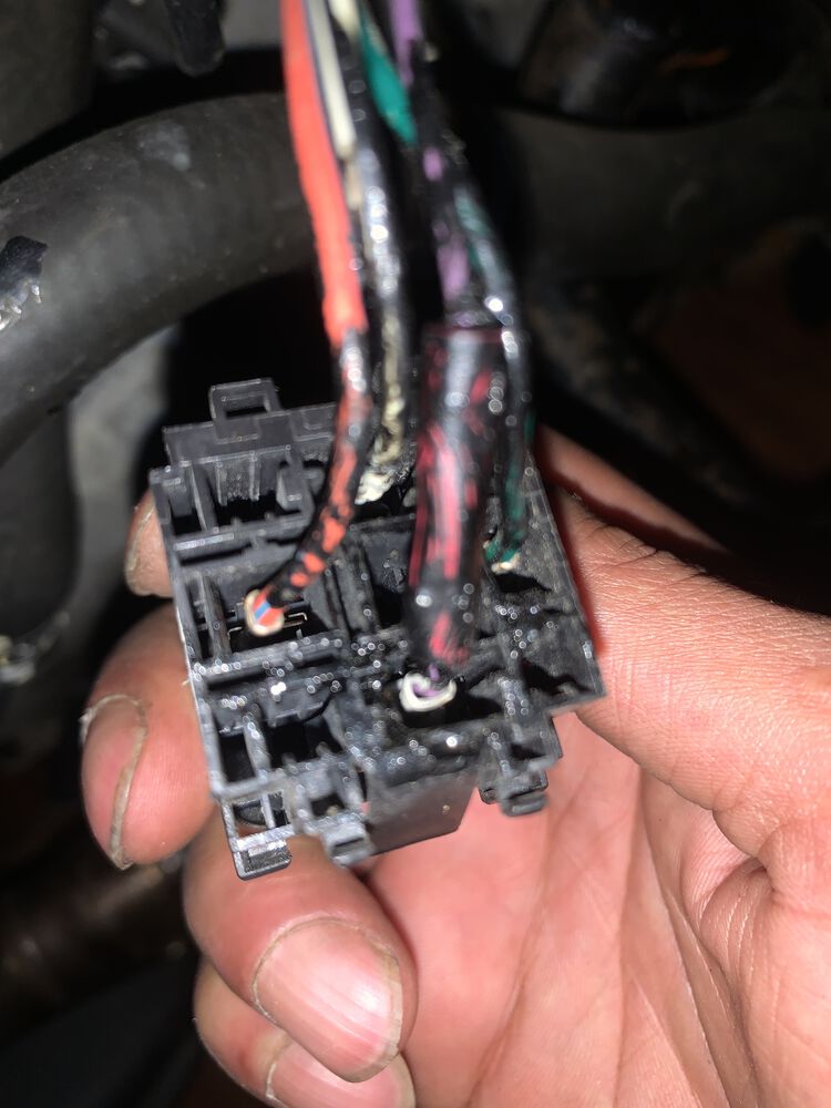

Here's un update could it be this part it's burned !!! Blown ! It's my only guess

Am I reading this wrong, or did you put a new fuel injector in the bike, even though you describe it as running fine when you bought it recently?
Something got shorted out. I suspect the positive terminal of the battery was arcing against the frame or some other positive wire came into contact with the frame or engine. .
Depending on how much of the wiring harness looks like the relay holder you showed, you might have a large paperweight on your hands. A new wiring harness will set you back about 400-500, if they are still available, and plan on about a day and a half to install it at whatever the current shop rate is where you live.
And despite what was said above, no dealership is going to take a bike back after the owner sets it on fire.

Thanks for replying! I found actually a lot of the whole wiring system for the bike for really cheap like 40 bucks maybe that should do it !? Idk how much shops charges for diagnostic in New York
