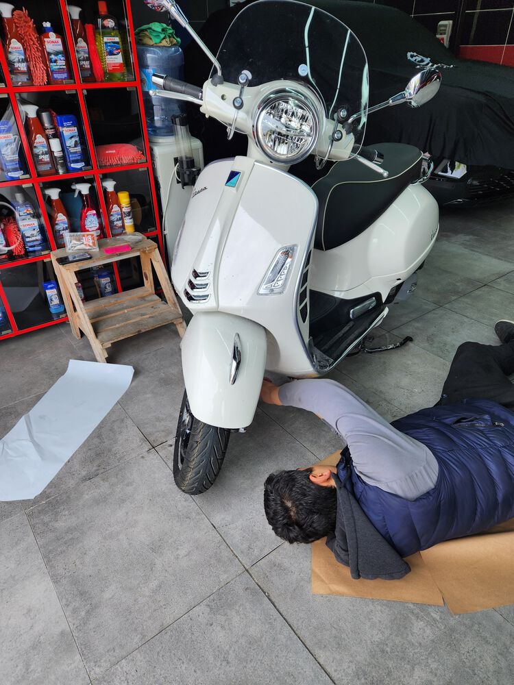

After readiing lots of rust topics, i did decide to put ppf film just above the front seam line and covering the whole front area and under.
My question is, they did applied this with a water and a little bit of moisture is trapped "maybe" is this going to be a problem espacilly on the seam area? or am i overthining it?

I would think the small amount of water needed to apply a film would evaporate well before it could become a problem. I wouldn't worry about it.

When debris from the road collides with the frame around the front wheel, it can cause the affected area to rust over time.This is the reason why i did cover it up with ppf.
Am i wrong?

No, seems logical to me.

Automotive base color coats are water based before the clear coat, the product still "breaths" for quite some time before being cured and hardened, your protective product is probably fine.
I live in a low rust area but I still clean and wax the front and floor to rocker under-seam areas regularly, it's probably unnecessary as the bike is well put together at the seam/welded areas.
I'd speculate that these later Vespas are built and treated with modern auto industry like corrosion protection processes.

I did the same with some strips of bicycle PPF, it worked fine...
