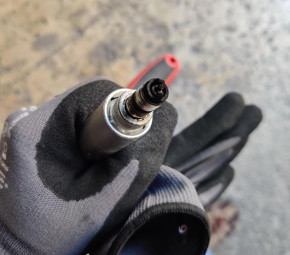

Spark plug is cheap and easy to do. When you remove this, take a picture of the end of the old one and post it here. People can tell from how the spark plug looks, how the engine has been running.
Posts: 46376
Posts: 46376
It's the bottom (away from the tip) of the 'white' insulator that's important to make judgement - just a side view only gives a hint.

I replaced the spark plug. Image of the old one attached. I'm not sure the picture is good enough but it looks a bit to black to me...

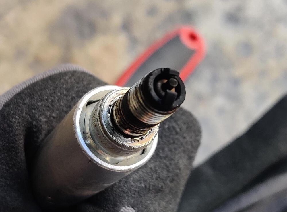

This one is more uplcose

That is a dead plug. It has expired, it is no more. It also indicates the engine is running very rich. Replace.
I'd also immediately be checking and adjusting the air/fuel mixture and the idle stop-screw:
Turn up the idle so the engine is running freely, and adjust the A/F mixture to get maximum revs. Turn down the idle stop-screw to a normal idle, and double-check the A/F mixture is optimised. It may take a few goes to get it spot-on.
