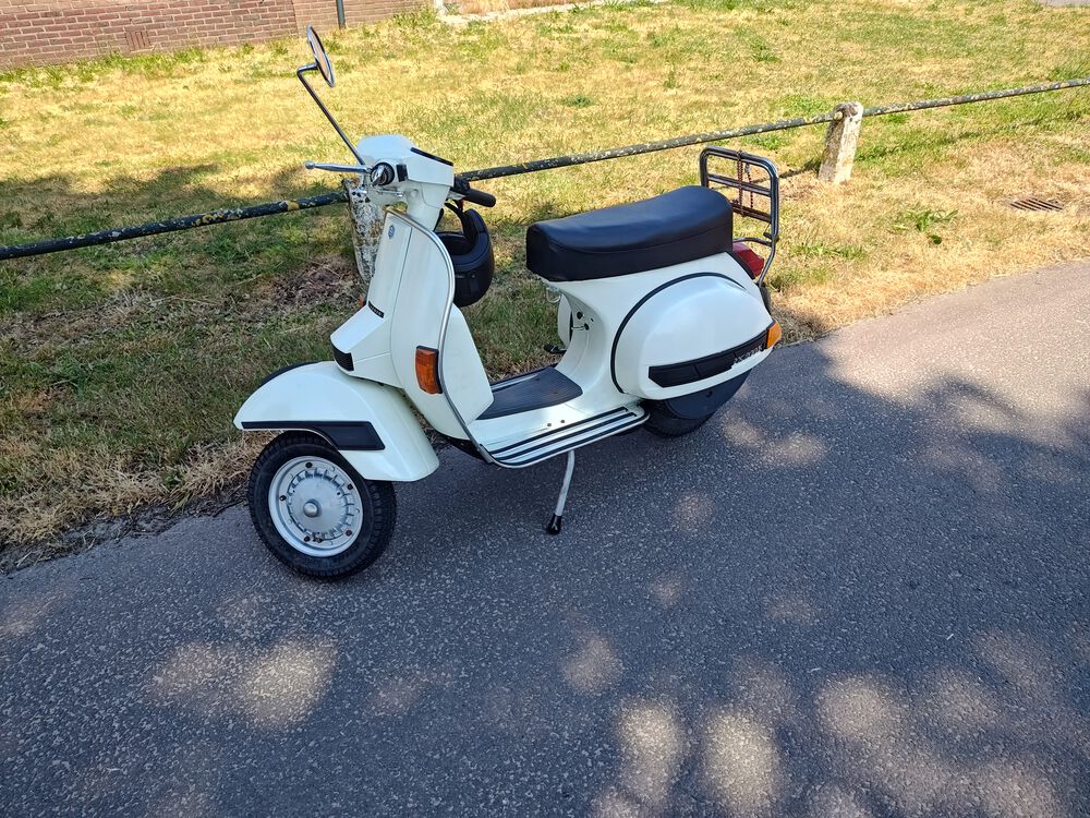

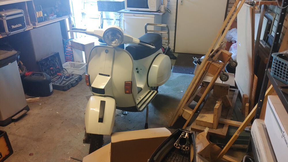

Voodoo I am not at home right now, but this is a pic of my scoot where I am almost done! Will take a better picture when I am back. Your help is much appreciated!
Posts: 10137
Posts: 10137
OK, dues paid up for now. I must say that I love me a clean white P and a late model 200 w/ disk brake and column ignition/lock is so hard to find in any condition. Yours is a gem, and I'm looking forward to more! Popcorn emoticon

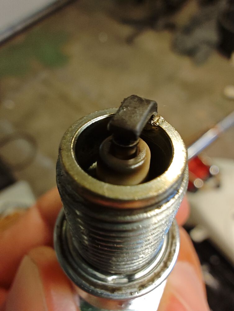

So I put on my bad boy shoes and went for a longer ride. 6 km away from home the scoot dies. Had some tools with me because I did think something would happen. But first took the opportunity to make a picture.
After a while I found that there was no spark anymore. Never had this but I replaced the spark plugs the cap and wire but I ended up walking home.
The spark plug color was like the picture below. Now I have to find the culprit of this problem...

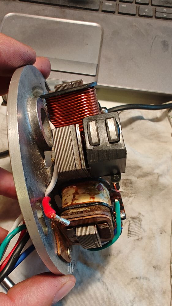

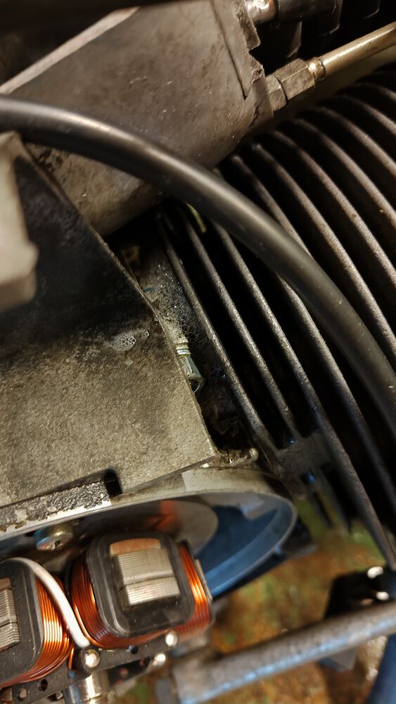

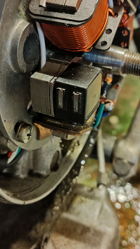

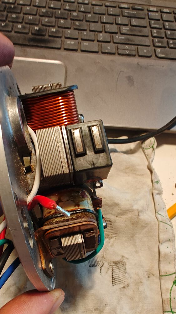

I don't know if someone is still reading this, but I will give an update anyway .
I did the following things to check why I don't have a spark:
- Check for a spark without the green wire attached to the CDI
- Try a new CDI
- Measured the resistance of my stator (all was good)
- Tried a new plug/plug cap/plug cable
After all that I still did not get any spark, but yesterday I assembled everything again and what do you know, a spark!
Now I am fearing that there is something wrong somewere and it can pop up at any moment, but lets see.
I tried running the scoot again and noticed that when I run it in idle it runs fine, it revs fine too. When I want to leave in first gear it almost dies with the throttle opened a bit. I have to fully open the throttle to drive off. When driving in second gear and let go of the throttle, the vespa almost dies.
The dying when driving away gave me the idea that the adjustment screw is to rich, but dying after letting go of the throttle gave me the idea that it is too lean. Do you guys have any tips for me?

Check the gearbox oil is ok. No power unless full throttle is symptom of an air leak.
Otherwise. Broken stator wire. Pull the spade connector to check any wire isn't internally broken.
Pilot jet blocked?
Do a crankcase pressure test.

Thanks for the suggestions Jack!
The stator is fully checked and seemed ok.
The gearbox oil and pressure test are the next on my list. Those have not been checked yet!

So I just applied the Dirko to the air leak spot. It was a logical fail, the gasket of the two cases was just pushing against the gasket of the cylinder. Cut a bit of gasket away and applied the Dirko so now waiting for it to set and measure for air leaks again.
In the meantime I wanted to install a new pickup because of the lost spark without a clear reason the other day. Attached a picture of the old one and the new one. Needless to say that this one is going straight back. Facepalm emoticon
