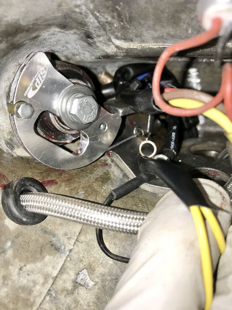

So how do i get the throttle tube to snap back closed? I have super crisp snap backs with all my P, PK, and S3 Lammy scooters (both with stock and aftermarket carbs). But with my VB1 (that has a P200 engine and 24/24G carb) it's mostly just a poor man's cruise control. Things i have checked-
-the throttle tube rotates VERY easily and smoothly.
-the carb slide slides VERY easily and smoothly.
-both the inner and outer cables are brand new.
-the inner cable slips through the entire length of the outer cable VERY smoothly...except for the very end of the cable where it makes a sharp bend right at the top of the headset, as it makes a sharp turn into the cable retaining bracket.
Is there anyway around getting smooth snap back with my throttle tube, or am i stuck with it being sticky? And i do realize that the early Vespa throttles didn't snap back , but i was hoping to have mine do it though.

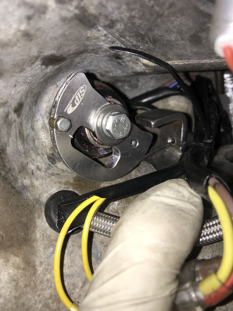

pic of the SIP pulley that i tried using

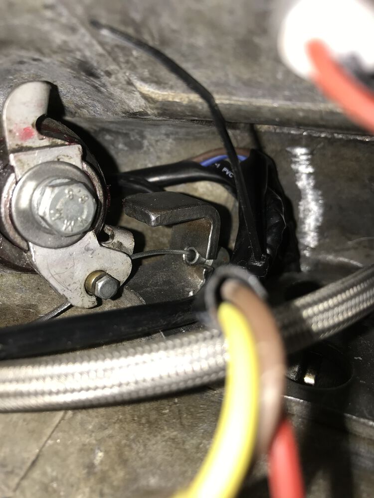

Pic of the stock pulley installed

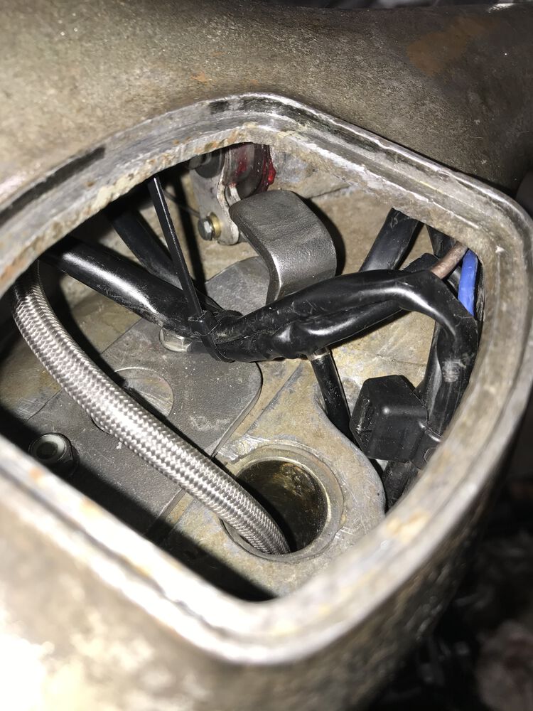

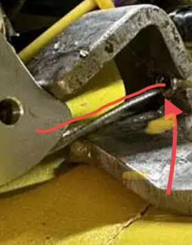

a pic of the bend of the cable
another pic that shows the cable routing

HAS to be the cable binding at that angle.
If you remove the top hat will the ferrule snug into the socket?
Maybe you could try (or fab something similar to) this if not.
https://www.treatland.tv/ProductDetails.asp?ProductCode=throttle-cable-90-cable-guide&utm_source=googleshopping&utm_medium=cse&gclid=CjwKCAjw3ueiBhBmEiwA4BhspCAZFty0Fa8xczvAYTfizwcal-7JCd0rIXM9jYTTqDUZnLJrQDtfihoC81wQAvD_BwE

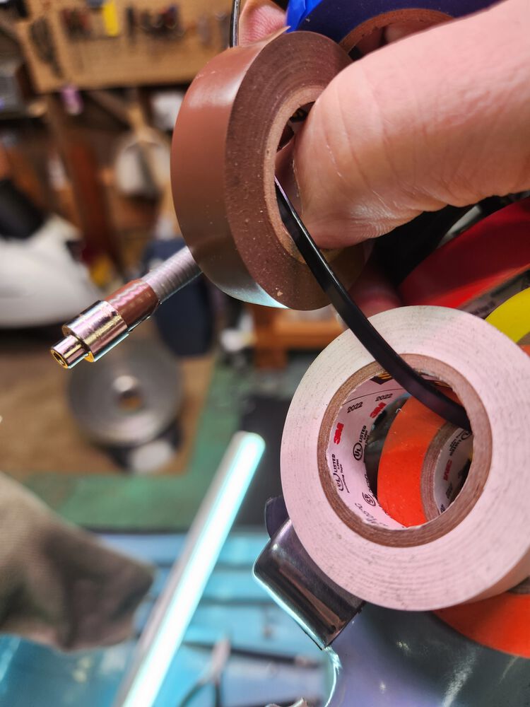

If I understand this correctly, maybe a layer of tape on the ferrule to tighten it up in the top hat?
I had this exact same thing happen on the 63 GL. The ferrule was too loose in the top hat, and caused excessive rubbing, making the throttle not return all the way. A thin wrap of tape solved the issue.
CORRECTION - It was the 62 Allstate
Much better, cable now slides smooth through the top hat

I did try something similar a couple days ago and it didn't work for me. I just took a peek at my Allstate, and the split head headset's throttle cable comes in at a much more direct angle than on my VB1.

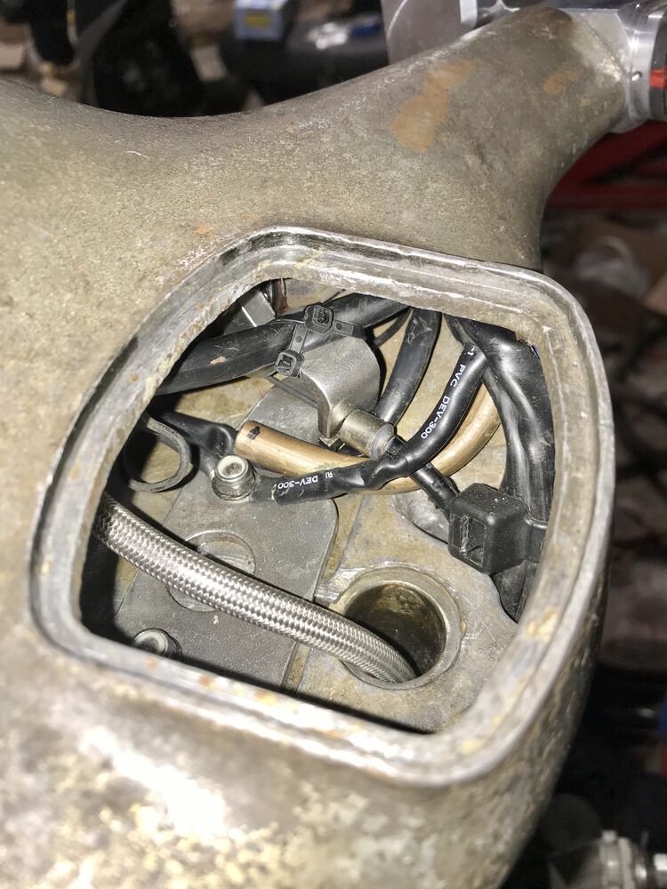

Other thoughts-
- is to use an oversided outer cable (6mm instead of the 5mm) and still use the standard size inner throttle cable?
- is the throttle cable routing supposed to go underneath the wire harness or above the harness?

Underneath I guess. If you place it over, the cable is not in straight line with the fitting

Anything the inner throttle cable rubs against is going to cause drag.
The top hat is usually the biggest culprit. There needs a straight shot from the pulley thru the bracket, and then from the top hat thru the ferrule.
There also needs to be a straight shot where it exits the outer cable going into the carb. Using the shortest outer cable possible is also a great tip.

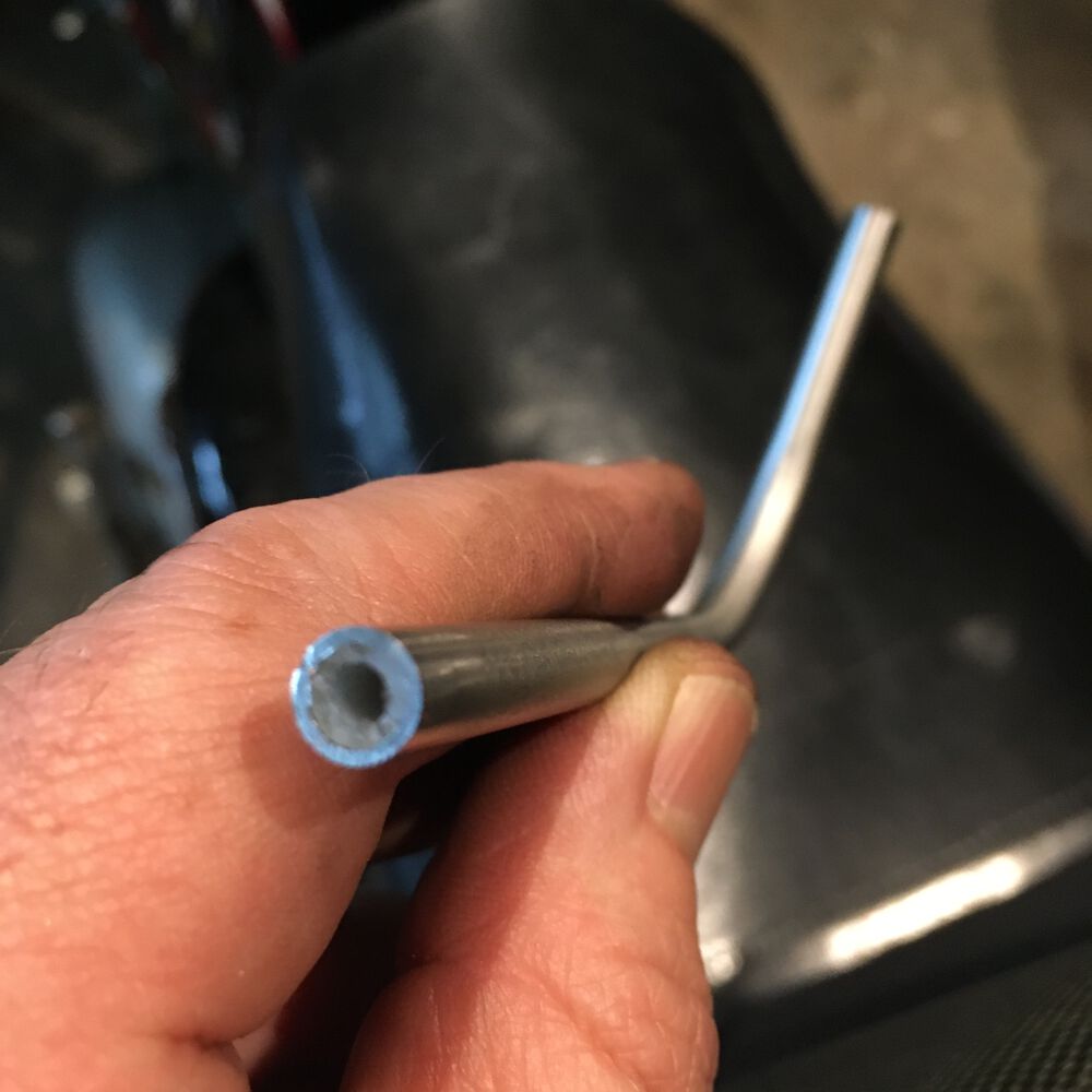

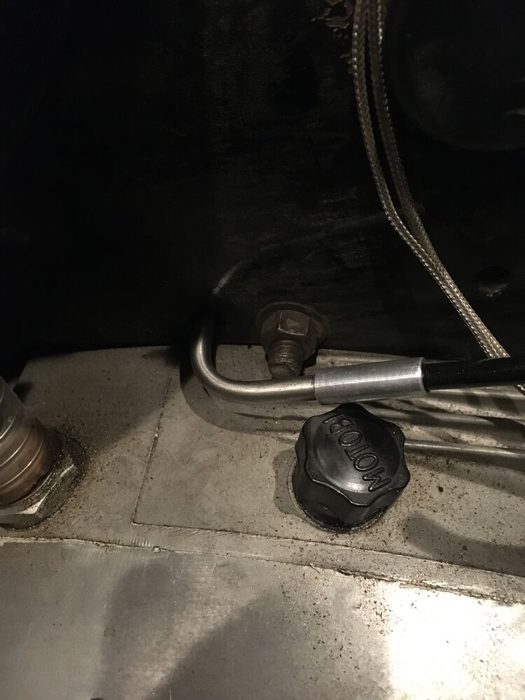

on my MotoBi clutch I used a 1/4" stainless tube with a teflon tube inside it to make a smooth bend through the frame.
seems like a similar approach could be done here with the right fittings on the ends.

I like this solution a lot … patrick, where are you getting Teflon-lined stainless steel tubing?
@oopsclunkthud avatar
1:3
Posts: 9385
1:3
Posts: 9385
bought separately, it's a snug fit when they are straight and then when you put the bend into it (with a tube bender) they lock together. Then trimmed to length after bending and filed the ends square with a jeweler's file guide.
McMaster
https://www.mcmaster.com/89895K723-89895K224/
https://www.mcmaster.com/5239K11/

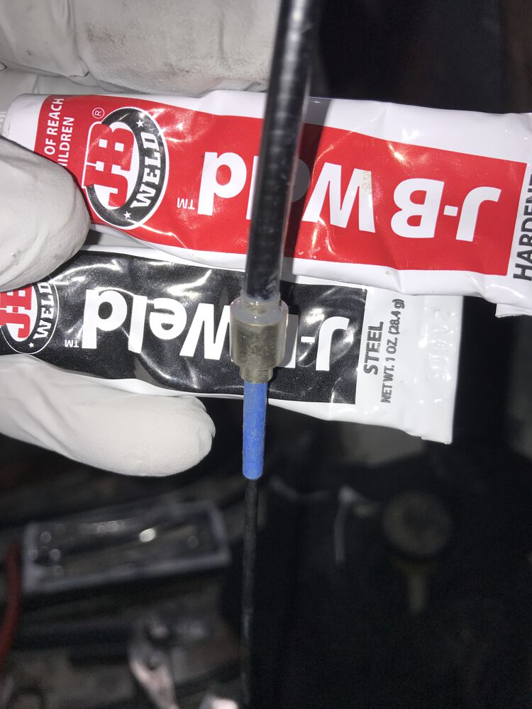

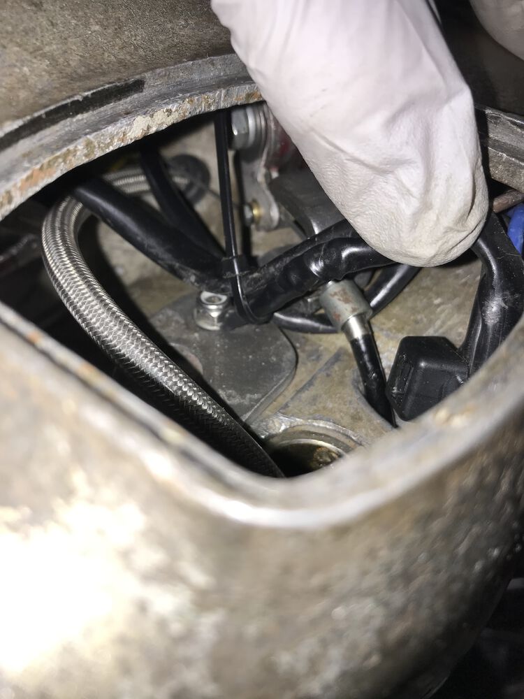

Aaaaa-SNAP!
It took quite a few hours to get it sorted, but i now have a very aggressive throttle return snap. You can probably hear the snap from 75 meters away! Some of the things i did were-
-i diluted the grease on the inner cable with "Cable Life" spray lube. It thinned down the grease enough create less friction.
-i thinned down the throttle tube grease with Tri-Flow lube.
-JB Welded the outer throttle cable (and ferrule) 100% dead center into the top hat. Thank you Ray for the pro tip!!!!
-slipped a round spacer (about 5/16" diameter) under the throttle cable so that it would support it at an acceptable angle.
Thank you everyone for their input! It was VERY much appreciated!
I jammed that 5/16" diameter tube under the throttle cable. It looks ghetto, but it works perfectly.
no binding or rubbing as the inner cable exits the top hat.
