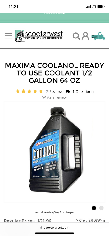

Hey all I'm finally getting ready to get my GTS 300 road worthy again. My only question that I have is will one bottle of this coolant be enough to fill to required level?

I believe the capacity is 2 liters and you have 64 ounces there, so It should be enough to fill it up. I would suggest flushing the system with water distilled or garden hose( depends on where ya live) and then add your coolant and then make sure to remove the air out of the system. There is a Robot video on a coolant flush on the internets for sure.

One bottle was enough but I bought a second one because I had the OE pink coolant in the machine beforehand and found out coolant brands shouldn't be mixed, so bought a second jug and flushed a 2nd time new green coolant with new green coolant a few days and about 50 miles later.
Not sure if the OE pink and Maxima green play nicely together but I didn't want to risk it as there is no way I got out all the old OE pink coolant out.
Could have flushed with distilled water and did the job once but then wouldn't there be water left in the system and ultimately not be 50/50 coolant/water blend?
