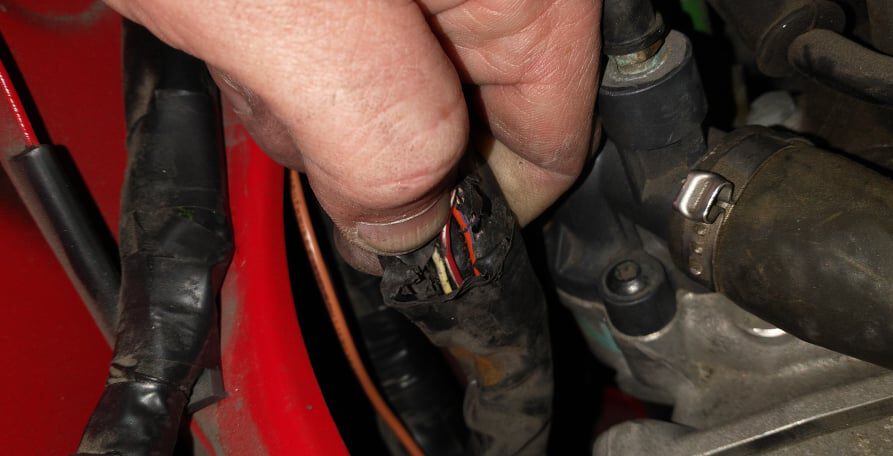

Check the harness that runs along the right side of the engine. My friend had a similar issue. It usually wasn't enough to pop the fuse, but it was the wire for power to the Engine Control Unit (ECU). It would go to ground because it was rubbing against the frame. The routing of the harness in the 2010 prodution time period was prone to rubbing against the frame.

Harness rubbed through
This is a very common fault.
