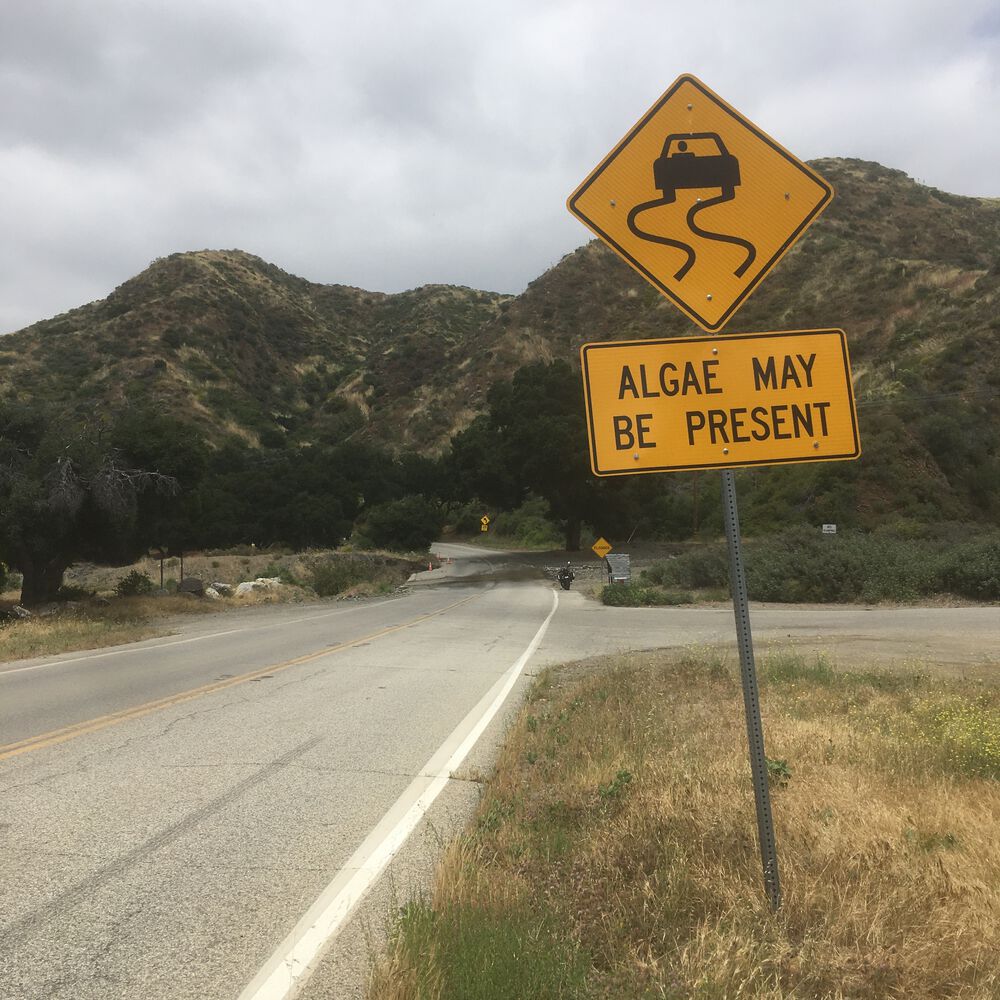

This morning I rode my motorcycle up Big Tujunga Canyon, one of the nice twisty roads around here, and after you go over the top and partway down the other side there is a water crossing where a creek just plain crosses the road. It's usually not too bad and will most likely dry up completely by August, but a few months back it was impassable due to heavy rains. Today it was easy to cross but as it dries up to just a film on the road it can be treacherous, so much so that there's a warning sign, a version of which may have helped you:
We got one of those, doesn't stay wet long enough to grow slime water (usually) but after it dries there is usually gravel to look out for.
