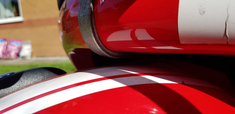

Thanks,yes the rack with all those metal badges weighed about 10lbs , but the reason i took the rack off, was i realised the headlight cowl was rubbing on the top Fastener & i could just feel it in the steering & i think it looks better(pics).
I've checked out SIP, did not know about them, they have the parts in stock, but shipping is a bit high(compared to parts cost) to the UK from Germany,i'll check if the local Vespa dealer has them on Monday, they'll be more expensive but no shipping cost , so we'll see.
Once again when working on the Bike i've found whoever did the work, did a bodge up using a posi drive self tapper & not using the original fastener & Torx screw , i believe if the original owner knew the standard of the work i've found when doing jobs he'd be horrified, he was a really genuine guy.
