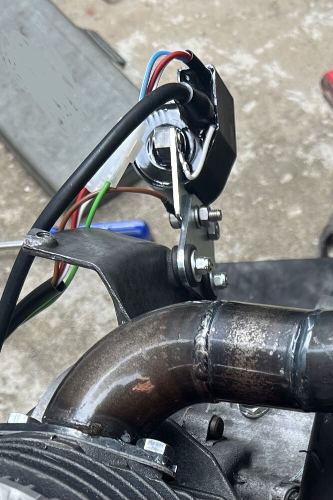

How's the vape attached to the engine? Resistor spark plug cap?

Sorry but can't understand. How stator plate attached to crankcase? It was full Vape kit from SIP with all hardware.

Yeah attaching with the SIP kit didn't work for me, removed all the brass and rubber pieces.

My is attached same as on your photo. But after last engine rebuild I noticed that killswitch button not works. I added extra ground wire between CDI mount and chassis and then killswitch button work again
