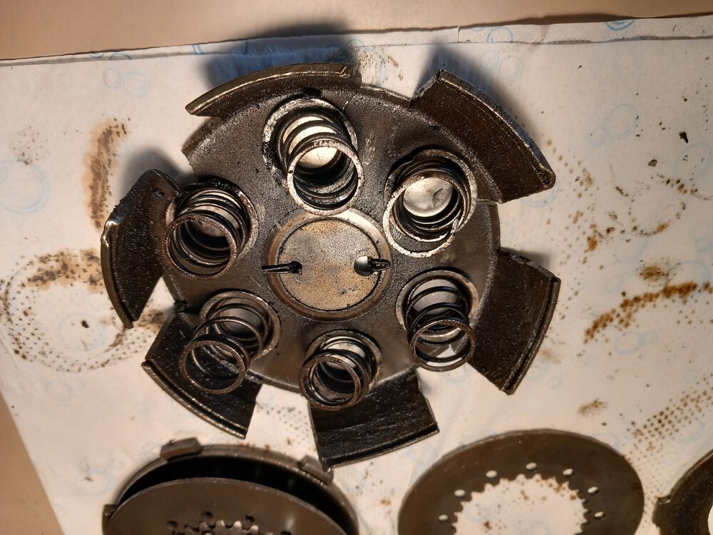

I have been slowly getting round to working on my gtr 125 and discovered that the clutch exploded which is why the think wouldn't turn. anyway, I need a new clutch, but the crank looks like it wouldn't hurt being replaced
On seeing the picture. There is pretty much no doubt.
https://www.sip-scootershop.com/en/product/clutch-sip-cosa-2-race-ultrastrong-22-teeth-primary-64-65-67-68-teeth_93404300?cr=3a6304bb-cc81-4ed5-9f63-1ff45fe1abfa&gad=1
Buy this. Forget about clutch issues, forever.

You saw the pic of the clutch. no idea how that happened, happy to replace with stock. As for the crank, the woodruff slot is a bit flared, bearings just slip on and off one side and there is a slight wobble to it so difficult to see in a picture.

The stock clutch type you have is awful. Old and out dated, stiff to pull, draggy, and prone to doing what happend to the last one. If you like originality, keep it but better functiallity and reliability are readily available.
