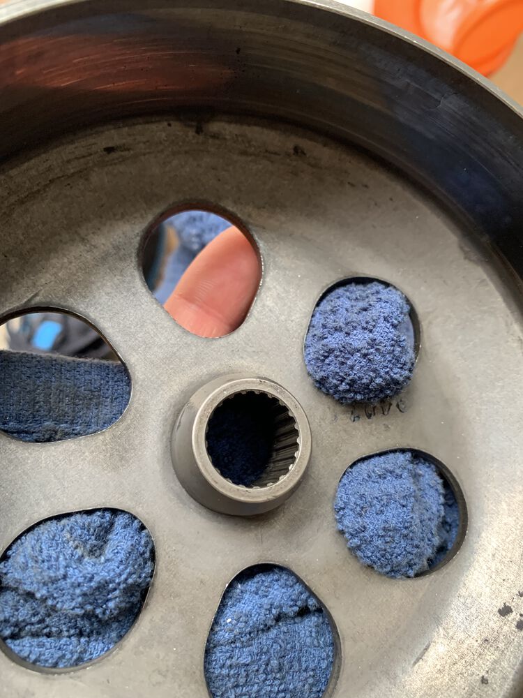

let's see a shot of the clutch bell.

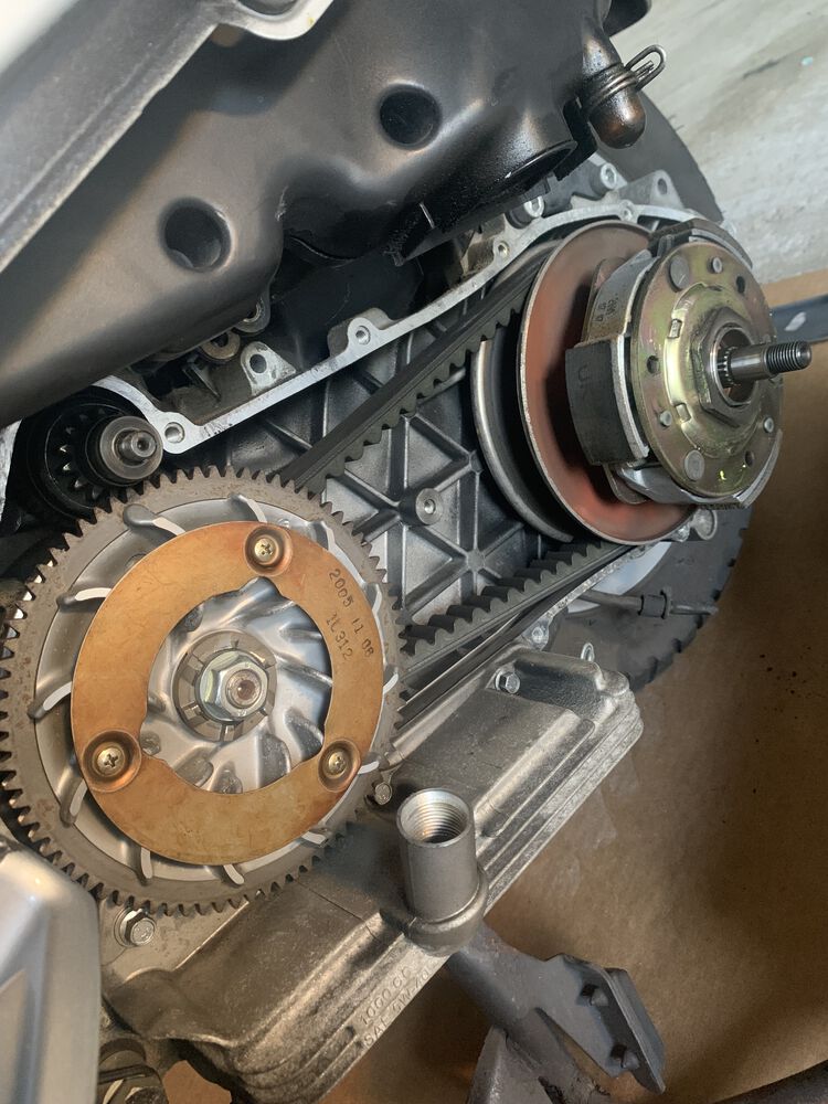

if you can let's see some pics of the drive, the bell, and the wheel mount.

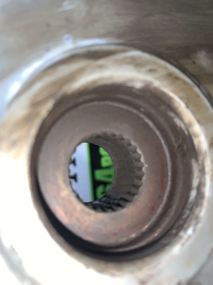

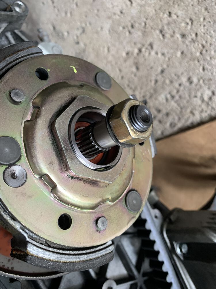

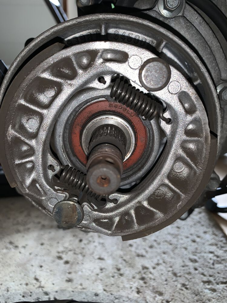

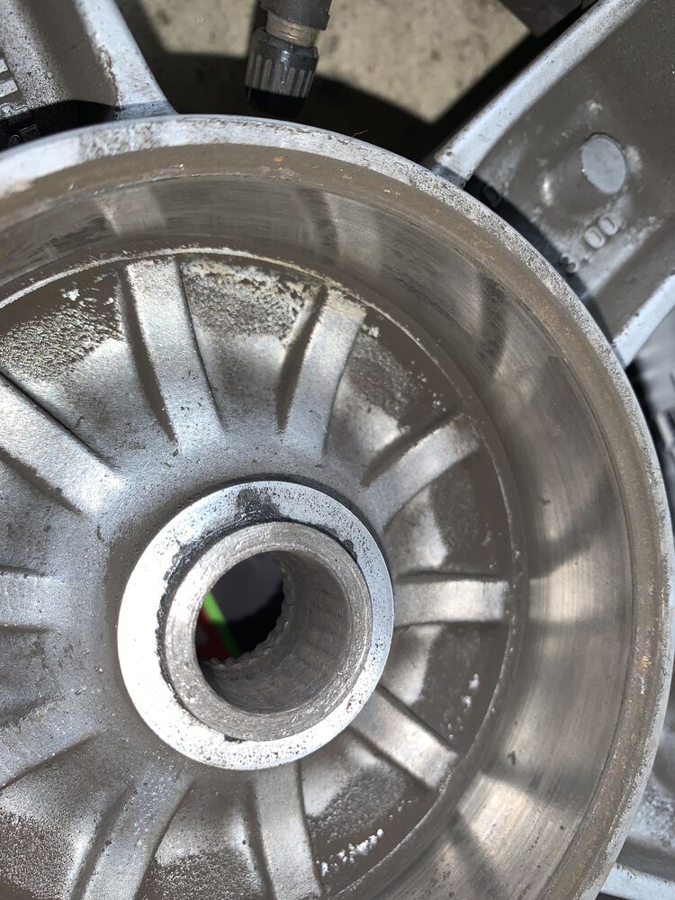

Inside picture of the splines of the clutch bell first please - if you think they're OK we'll want pics of the splines of the final axle and inside the rear wheel.

I believe I found the issue, let me know your thoughts
After taking off the wheel you can see that the splines in the rim are completely worn. Assuming this happened because I noticed the wheel had play in it and it was loose. It was not hard to remove the rear wheel nut.
All pictures you requested are attached.
Bell
Bell
Splines on clutch
Splines on clutch
Rear tire axel
Rear tire axel
Rear wheel splines
Rear wheel splines
Rear wheel
Rear wheel

There's your answer - a new wheel is required. The axle nut should have had a castle cage over it and a cotter pin through the axle.
