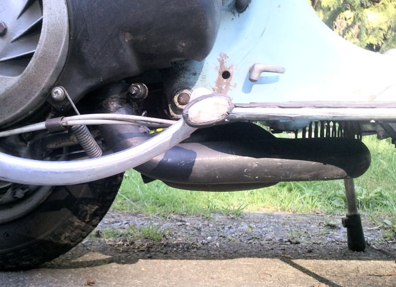

I had the same problem on my AllState. I cut the tab from the centerstand and welded it back on more to the left so it missed the muffler, and moved the frame end of the spring over too.
You can sort of see it here.
